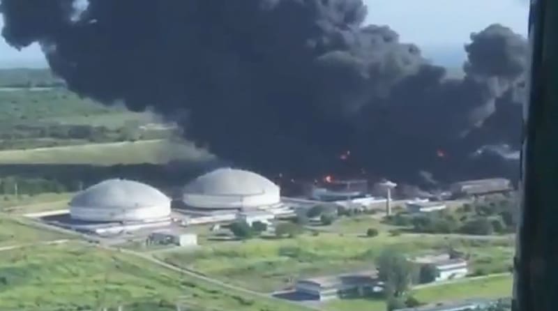

Spectacular Oil Tank Fire in Matanzas, CUBA ... Caused by lightning ??? 4

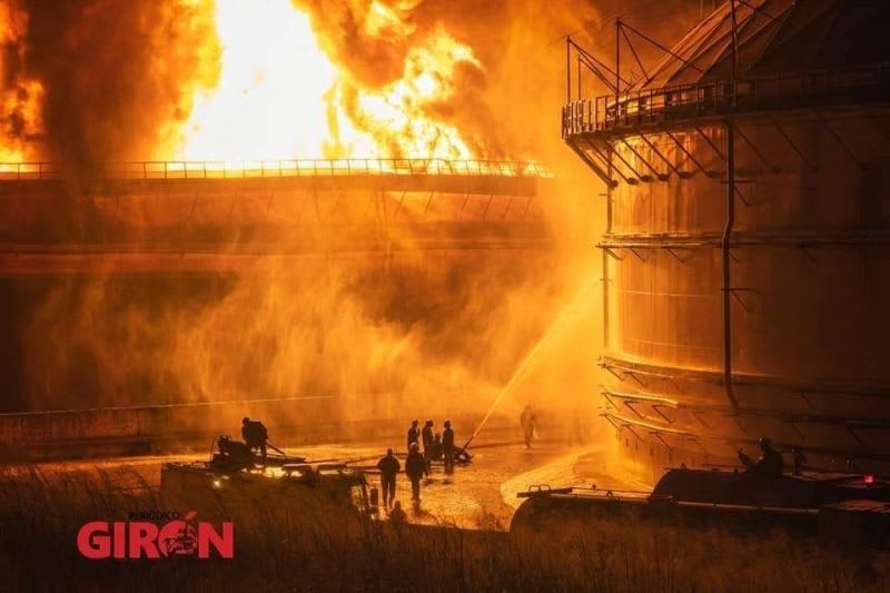

Just released picture:
Twitter account said "JUST BEFORE THE SECOND EXPLOSION !!!!!!"
/i]
DOZENS HURT AND SEVENTEEN MISSING....!!!!!

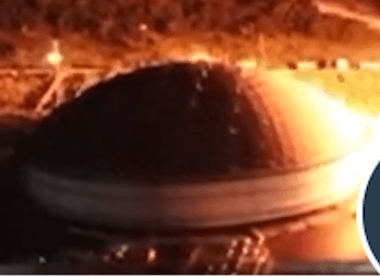

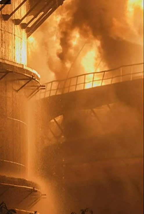

In that picture they're doing boundary cooling on an adjacent tank. Is the spacing between tanks considered so that they would not require require boundary cooling in such a situation?
Looks like a dome tank roof, not a floating roof. The poles on the roof are likely air terminals or supports for suspended air terminal wires.
clipped from the cbs video
There is the possibility that the headspace contained an ignitable mixture, particularly with the tank being heated by the adjacent fire.

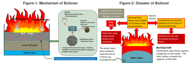

Unlikely, heavy oil does not BLEVE. A boilover accident is a possibility.
[URL unfurl="true" said:
https://en.wikipedia.org/wiki/Boilover[/URL]]NFPA defines boil-over as: An event in the burning of certain oils in an open-top tank when, after a long period of quiescent burning, there is a sudden increase in fire intensity associated with expulsion of burning oil from the tank.
I have seen this once, fortunately not associated with fire. Tank (volume about 5,000 gal) had about 8 feet of oil/water emulsion in it and perhaps 3 feet of water. As attempt was being made to de-emulsify the water the free water in the bottom was heated above 212F, perhaps to 215F. At some point the free hot water became buoyant enough to start to rise into the oil, where it did boil, creating a very rapid rolling of the oil in the tank, and liberating enough steam to shoot the oil & water froth out of the manhole and - we think more than 100 feet in the air. It left a rather large area to clean up.

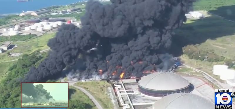

That local 10 link is the best by far.
These are a few screen grabs, but it looks to me like this is a dome roof tank, possibly with an internal floating roof, but it may have simply replaced or originally built that way and with some sort of tank breathing system.
However it looks like once it caught fire, it has simply buckled and the "explosion" is more likely to be simply the tank partly collapsing and spilling out large quantities of burning liquid which once it got some more surface area went up. You can see that the fire has spread outside the tank bund and in looks to me like the second tank has been completely burnt to the ground.
Second tank looks destroyed
tank rim starting to buckle
Fire pool extending into the bund
