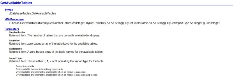

I need help regarding CSi API. I want use database tables with, I'm doing my inputs and output correctly, yet i'm getting this error. "No method 'GetAvailableTables' with matching signature found for class 'CSiBridge1.cDatabaseTables'." even though i checked using methods command and everything seems fine. This is what is wrote
[ret,NumberTables,TableKey,TableName,ImportType]=cDatabaseTables.GetAvailableTables
Is there anything wrong with it ?

I'm using MATLAB. I don't know what might be wrong. table_data might be python specific and not working in MATLAB. I've attached image of syntax from CSi's guide.
My output parameters are right. Still it returns error

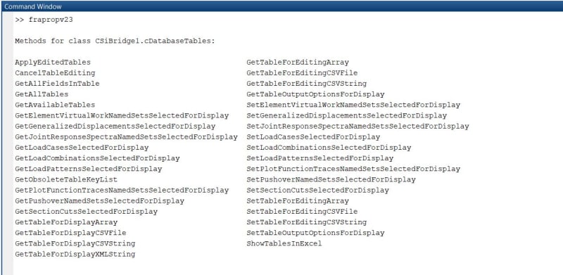

It returns following error
No method 'GetAllTables' with matching signature found for class 'CSiBridge1.cDatabaseTables'.
However when I check methods by using methods(cDatabaseTables) it contains get all tables.I'll attach picture below.
and the error is in picture below
this time I was using GetAllTables instead of get available tab;e
