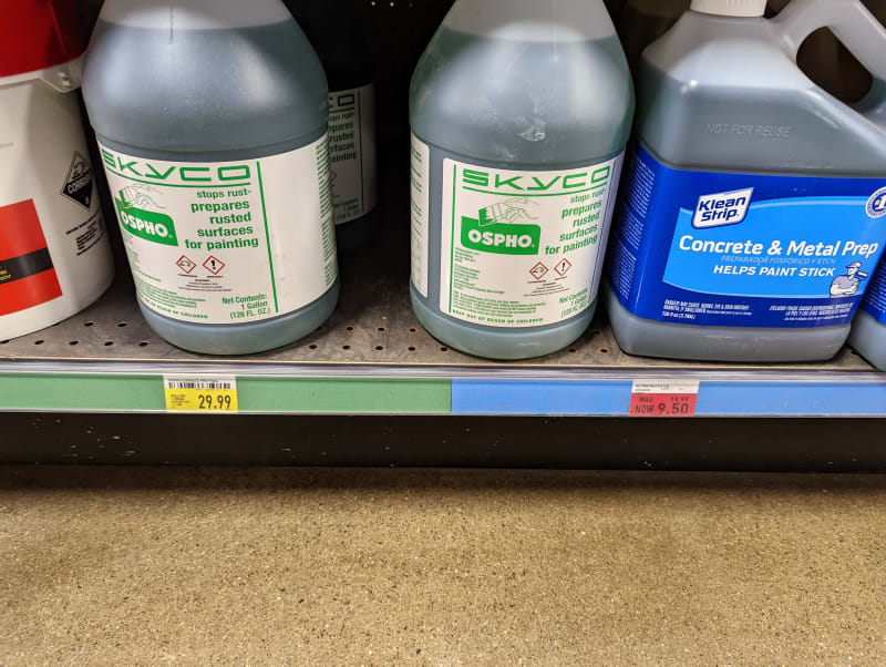

You can get phosphoric acid at your hardware store. It's usually sold as concrete etcher.
Same product different labels.
Anyways, it's a bit simpler than the electrolysis method. Make sure you neutralize to prevent flash rust.

Well here is my update... Thank you 3DDave for your suggestion about Shawn Woods. I will watch his video after i'm done writing this update. Well, I was able to make time today to finish stripping down my 336. You guys are correct. The lever and the trigger are no good. They are both past any repair. And as far as the receiver and the corroded part of the barrel. I decided to take TugboatEng's suggestion and I saturated the receiver and the damaged part of the barrel with phosphoric acid. I realize its kind of overkill but I am going to let these part sit over night and see what they look like in the morning. I hate to be a pessimist. BETTER SAFE THAN REALLY SORRY! ( Anything involving firearms is ALWAYS safety first and foremost!). But I am 85% convinced there is no hope for this rifle. By the time I remove enough material to get past all of the pitting and corrosion. I believe the receiver will not be thick enough to take the chamber pressure of the cartridge being fired. And I know me. No matter what I would have done to the rifle to have it repaired. (If that is even possible). I would never again be able to trust firing this rifle. I would ALWAYS be worried about the receiver exploding in my face. And I am sure a .30-30 Win. cartridge can do some real damage! Its simply not worth it. I have come to the conclusion . I am just going to turn it in to my insurance company. And buy a new one. One more thing... I AM going to catch that RAT!!!!!!!!!!!!!!!!!!!!!!!!!!!!!!!!!!!!!!!!!
