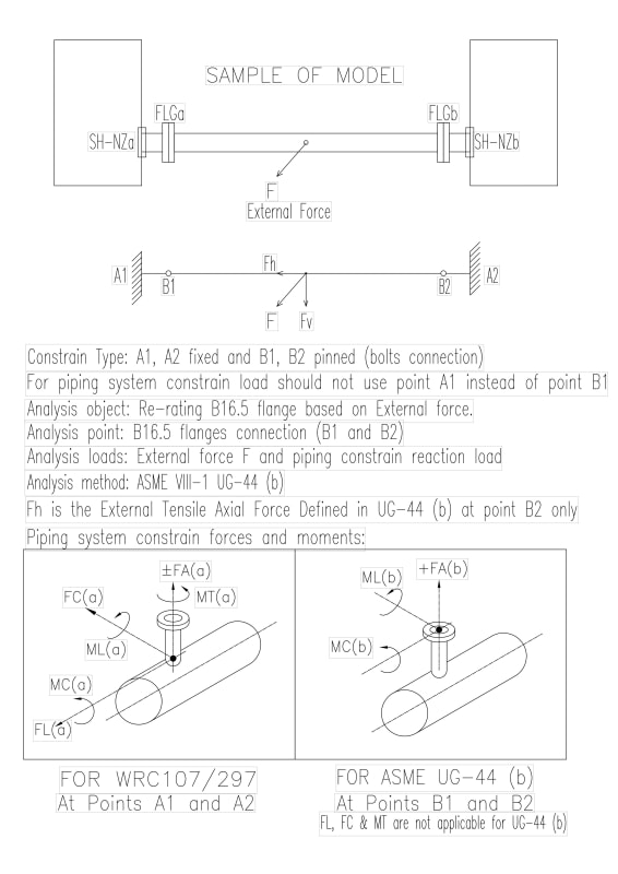

Piping Loads Apply for Local Stresses Analysis (WRC107/297) and the External Loads on Flange Apply for Re-rating Flange of B16.5 [(UG-44 (b)].
1. The analysis points are different. One is the nozzle neck to shell interface, and another is the sealing joint of a pair of flanges.
2. The loads are different. One is Piping Loads. That is the constrain loads at the point of the nozzle neck to shell interface, which derive from internal pressure, thermal load and boundary constraints on the integrated piping system by Caesar II analysis. The piping loads is applicable for WRC107/297 for local stresses analysis
Another is the External Loads on Flange EXCEPT piping loads derived from internal pressure, thermal load (as we know that the internal pressure and temperature have been already considered in the flange of B16.5). It is applicable for UG-44 (b).

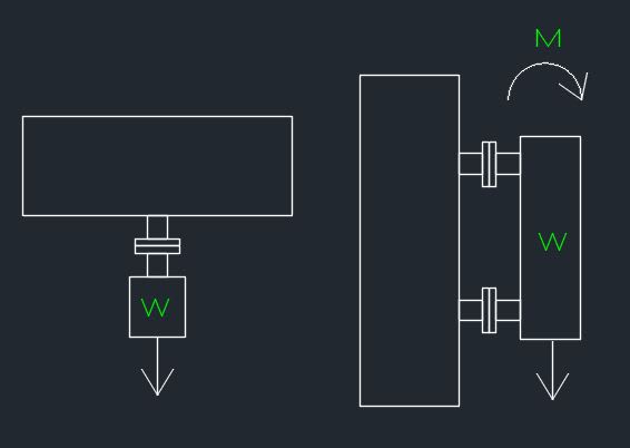

The below sketch may help to understand the external load on nozzle flange.
'W' shall be considered as the external force for the nozzle flange.
'M' shell be considered as the external moment sue to W for the nozzle flange.

My original post said the piping loads (from API660 table 2 or client specifications) that is not applicable for re-rating B16.5 flange. But I corrected and clarified it with my post at 16 Jul 22 08:10.
Analysis object: Re-rating B16.5 flanges as per UG-44 (b)
Analysis loads: External force 'Fh' and piping constraint loads at the flange joint (B1 and B2).
Force +F(b), ML(b) and MC(b) to be considered as piping constraint loads to re-rate B16.5 flanges. But +F(b), ML(b) and Mc(b) are totally different with +F(a), ML(a) and MC (a)because the constraint type is different. The constraint loads at points B1 & B2 should be less than point A1 & A2 due to 'soft' constraint (bolts connection). Therefore it should not use the nzzle external loads at point A from API 660 Table 2 (or client specifications)for UG-44 (b).
The flanges are not pinned joints, they are moment resisting, with typically less flexibility than the moment resisting connection at the vessel.
If you claim that the API 660 loads are not applicable at the flanges, then what loads would you use? Would the loads be lower or higher? And what's your justification for your response?
