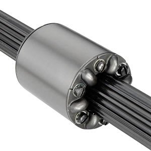

For that kind of load you're going to want a ball spline:
They're like a ball screw except they transmit torque instead of linear force.
