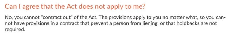

phamENG: not sure about anything state side but in Canada dik has it right. One of the courses I teach is construction law and I always review with my students how they cannot contract out of the construction act / lien / holdback provisions. We have a handy guide that walks through it in plain language too. Very interesting that it's much different where you are. Seems a bit odd that you have to "opt in" at the beginning of a project since you don't know if you'll want to lien or not until things get rolling.
