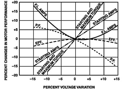

176 V line to line or phase voltage is very low for 690 V motors to operate. +/- 10% voltage variation is the design / standards limit to prevent motor burnout. Solve the root cause of the voltage sags. Many versions of voltage stabilizers are available in the market.
Muthu
I agree with Muthu Sir. Voltage dropping to < 176V for 4s is serious in itself and any further increase is not going to help.

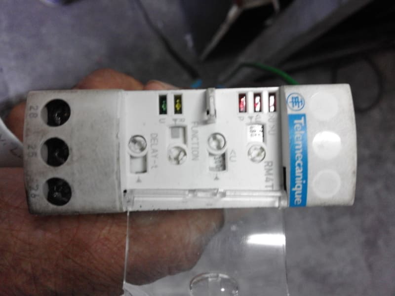

We had several power plant trips due voltage relay in four panels after network disturbance. Finally we had to bypass the voltage relays. Since then the motors have operated well without any failure.
Voltage relays are Schneider RM4TR32.
