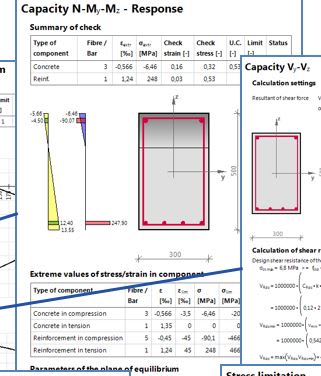

- Provide the detailed cross-section analysis for these points showing:
- Concrete Stress-Block
- Steel Strains
- Steel forces (verify compression bars inside the stress block are reduced by the force already accounted for in the concrete)
- Concrete Strain
something like this output:

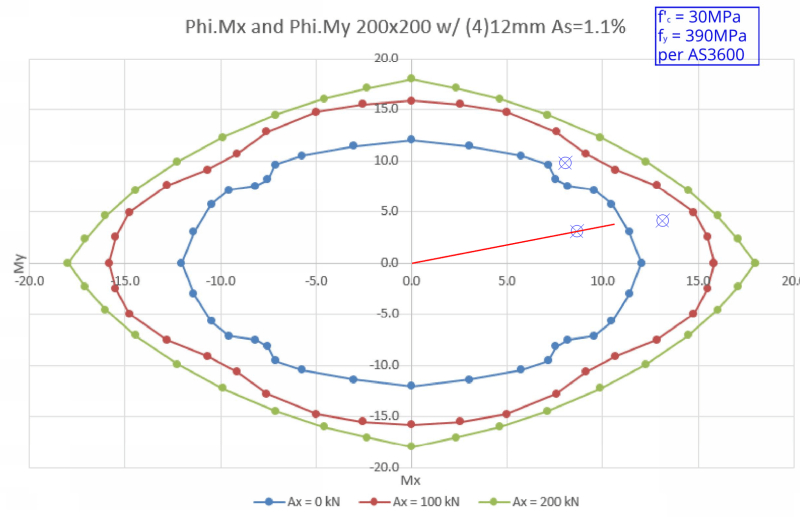

For now you may want to limit the bar layout to symmetric layouts only as I assume you are keeping the neutral axis orientation constant and just varying the depth which means for configurations like the screen shot below the P-M curve is not correct. The section as shown has both M2 and M3 values with a horizontal neutral axis which means the plotted curve is the projection onto the strong axis of the actual P-M slice.

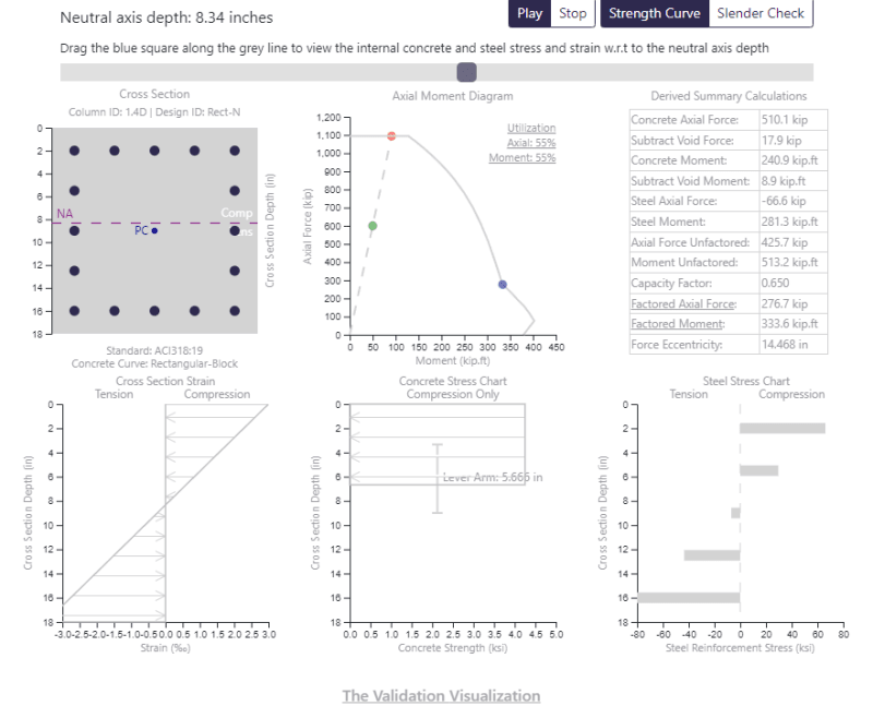

Great suggestions, thanks Celt83. I agree the existing plotting needs some more work. I also like the idea of a detailed view showing the strain, stress, and resultants over the cross section for a selected load. Back to SVG land for me.
For bars in the compression zone, currently I am using their exact stress, but then subtracting their area off of the compression block area. I guess it should result in the same thing.
CompleteColumns looks cool. Lots of good ideas implemented there, like this visualization tool:
This works fine but I found once you get into the biaxial stuff it was much easier to modify the bar forces rather then mess with the math of included holes in the compression block.
Yeah, currently I am not iterating to find the NA orientation. The result matches spColumn for an analysis 'locked' about x-axis. That will need to be worked on to get biaxial bending implemented.
