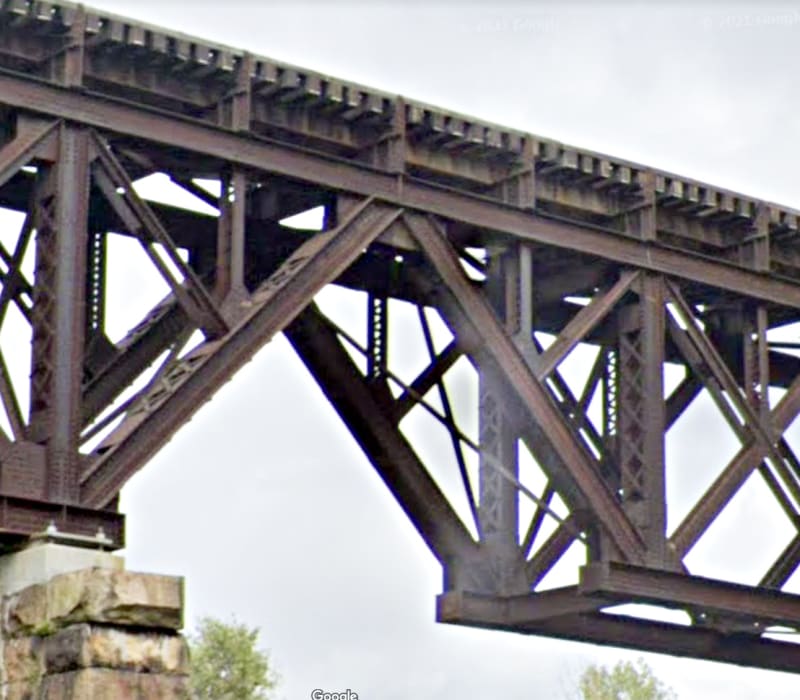

Also of some interest, though not on the large visual scale of the overall bridge:
Note that the cantilever joint is distinctly not pin-connected. Seems kind of strange, considering there is no other member that could halt rotation about that joint. Of course, if the tops of the bridge supports NEVER change comparative height, it shouldn't matter.
It's effectively a pinned connection, in that it won't carry significant moment (relative to the remainder of the truss).
Yes, I would certainly call that a pin, even though the top chord appears to be continuous. I wonder how that bridge was erected.
Hmmm. So we have here a pin-less pin joint. I would think, then, that there could be pinless pin and hanger joints, too.

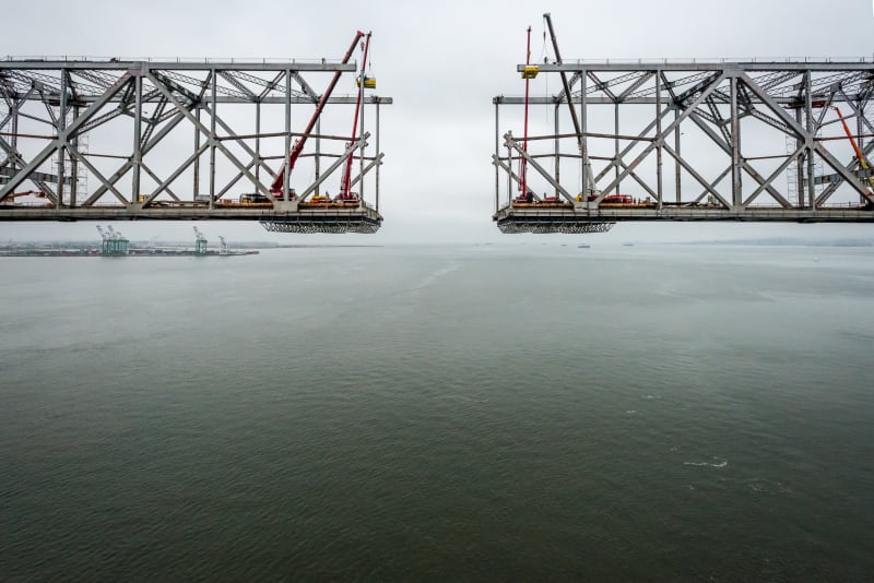

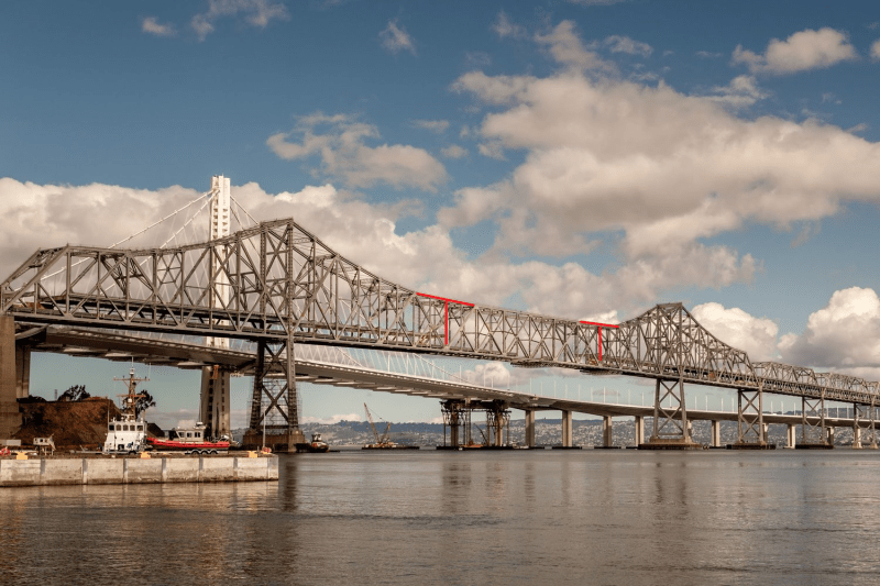

Yes, many cantilever structures with drop-in spans were constructed with faux-chords (and slotted connections) at the hangers. Or in some cases, a temporary chord was installed with a jacking mechanism to allow cantilever construction methods before the deck was placed, then later released to create the suspended span condition for full service loading. The SFOBB eastern span (and possibly Tappan Zee, Goethals and Carquinez bridges?) were examples of this method. I was privileged to be part of the dismantling of several of those bridges.

You postulated that this is a very unique structural system. It in fact is not -- just that often, other bridges using this system are camouflaged -- at times, to prevent that feeling of having "something missing" for members of the general public.
In this picture, the noted top chords are not performing any real structural function in the bridge during its service life -- "only" there to reassure the public. In your bridge, they were omitted. In this case, both during original construction and demolition, the "faux" chords were temporarily connected to allow us to do this:
