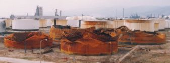

More than 20 yrs ago, i have seen the following tank farm ( post earthquake fire ) ..Notice that the tanks lossed the integrity and all of them collapsed.
I have the idea that, the crude oil storage tanks should be provided with fixed cooling water system regardless the tank is single or a group of tanks..

I am sorry but i disagree with you.. the fixed cooling water system is to protect the other tanks and vessels from radiation plus cooling of the tank under fire...The crude oil tank fire is totally different story.. when the fire builds up if without fixed cooling water system, you have one option.. keep far away, and abondone the tank..I have provided the picture at my previous post to draw attention ..

Key issue is whether the fir is inside the tank or in the bund around it....
But yes, if inside then you need to try and stop it escalating by having the tank collapse if you can't cool it.
