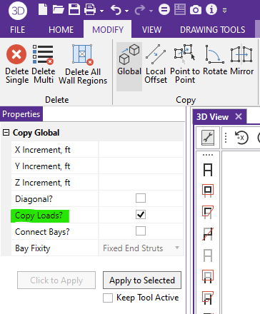

Hello All,
How can I Copy Area loads from First to second floors?
I tried copy- Global but it just copy elements
Thank you
RISA-3D or RISAFloor?
For RISA-3D, you could copy the joints that define the area loads up to the upper floor. That would do it.
For RISAFloor, when you create the floor, you should be able to base it off of an existing floor (I believe). Though I haven't used that program in a few years.
For the Risa 3D I copy The Floor With the loads and nodes but the program copy only the elements with no loads
If you don't have the nodes selected when you perform your copy, it won't copy the area loads as those are node dependent and not member dependent.
Also, when you click global copy, there's a check box indicating copy loads on the left hand side. You need to make sure that's clicked.
Piggybacking off of jayrod, see the screenshot below:
Note that this is in version 20. If you are using version 17 or earlier, your copy box will look different.
Duplicate the load to a new line in the Member Area Load Table and then manually change the label of the loads that are defining it.
thank you all It worked out One more question Is there any problem if nodes duplicated?
You could do a full model merge and the program will usually take care of duplicate nodes.
