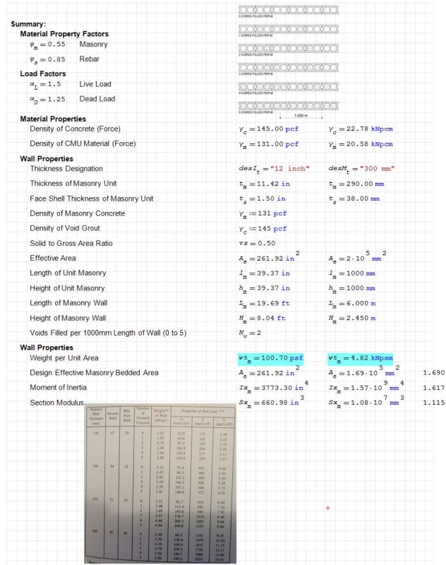

Hello,
Can someone write a formula for the net average moment of inertia (Iavg) of the CMU wall ? I have been trying to come up with a formula for Iavg but it is always way off the NCMA charts.
For example:
12" wall (11.625")
face shell = 1.25"
webs = 1.125"
spacing = 24"
Iavg = 1165.4 in2/ft
I appreciate your help. Thanks.

Do you know how to determine the net moment of inertia (not the average moment of inertia)? The average moment of inertia is done the exact same way, but you get to also include the contribution from every web even if they do not have mortar at the joints. This is because the average properties consider the horizontal plane at every height and not just at the height of the mortar joint where the wall is weakest.

For a 12" masonry wall grouted 24" o.c. the grouting pattern repeats every 3 blocks. Over that width you get to consider 2 grouted cells and 9 webs for the average properties (net properties only consider the 4 webs that are adjacent to the grout).
Cell Depth = Block Depth - 2*Face Shell Thickness = 11.625in - 2*1.25in = 9.125in
Cell Width = (Block Width - 3*Web Thickness) / 2 cells = (15.625in - 3*1.125in) / 2 = 6.125in
Iavg, face shell = 1/12 * 48in * ((11.625in)³ - (9.125in)³) = 3244.8in^4
Iavg, webs = 1/12 * (9*1.125in) * (9.125in)³ = 641.1in^4
Iavg, grout = 1/12 * (2*6.125in) * (9.125in)³ = 775.6^4
Iavg = (3244.8in^4 + 641.1in^4 + 775.6in^4) / (48in / 12in/ft) = 1165.4 in^4/ft
