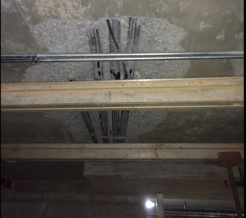

I'm seeking some advice regarding a difficult concrete repair that I'm undertaking. While I'm interested to discuss the possible causes of the problem, we're mostly just in problem solving mode at this time: how best to responsibly investigate and fix this. For context, everything that follows was copied from an email that I sent to our local Sika rep.
My cliff notes:
1) This is predominantly at column locations.
2) We suspect that uncleared snow on the form deck was likely the culprit here, perhaps in combination with vibration issues.
3) All of the stud rails are too low for cover in their current state. We’re contemplating additional concrete cast below the existing soffit level.
4) We have some concern for the snow having melted into the concrete and messed with the water content locally.
5) We have reason to believe that we have this same issue not just beside our columns but above them. This creates a soffit repair access problem.
6) As you can see, these areas are quite congested with two layers of bottom steel, integrity steel in two directions, and stud rails. It’s a lot of stuff to climb over top of with a repair.
7) My instinct with this kind of thing is to chip concrete away at least 1” above the uppermost rebar before coming back with repair material. That, both for repair longevity and for getting a convincing bond between the bars, the repair material, and the existing substrate. As you mentioned, Hilti has confidence in it’s partial depth repair solutions. You’ll need to dust your salesman hat off and see if you can convince me of the same as I’ve no doubt that our contractor would prefer that.

Assuming NOT post-tensioned slab. Difficult to tell the depth of the damage. I have chipped denser rebar congestion with success.
Shore slab.
Concrete chip from soffit. Standard ICRI details, like chip behind the bars, remove defective concrete/voids/honeycombs etc.

Maximum would be about 4" into a 16" transfer slab.

Outside of the lack of concrete those bars look like they are in fantastic shape! Which I unfortunately take to mean we are somewhere inside with expensive shit above.

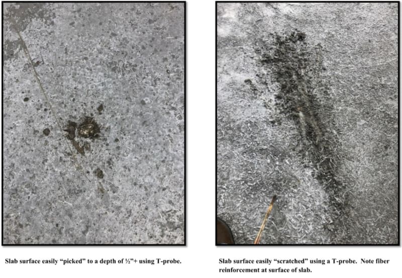

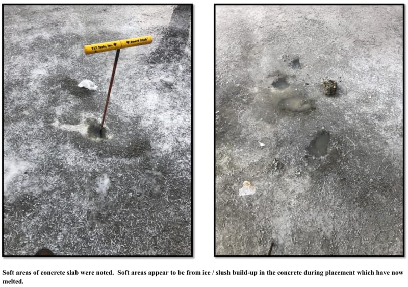

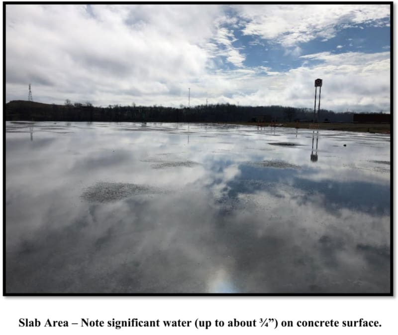

2&4) Yeah, snow on the ground/deck during a pour can have some rather gnarly consequences (in an extreme example):
I'm not sure what the bottom of the slab looked like as it was SOG, but I suspect as you/your colleague noted, the snow melted pretty much immediately and just totally fouled up the w/c of the slab. I'd suspect the voids are more of a consolidation/vibration issue. Note in that last picture - that's bleed water, no precipitation after the slab was poured. That said, how far can the excess water 'rise' up through the mix without any sort of agitation? The slab pictured above was 5" thick, so at least 5", but 16" seems unlikely? I'd definitely want to get a handle on the in place strength of the slab if you suspect there was water/snow on the deck during placement...

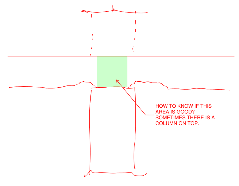

The petrographic analysis sounds good. Can it be expected to provide data particular to various locations within the slab depth as opposed to just an average of the slab thickness as a whole?
How do we feel about the potential for their to be crappy concrete right over the columns? Can that be assessed in some way? When the chipping is done for the repair, will it be feasible to try to chip laterally into that space?

Also, what's the best strategy for identifying the extent of the loose/weak soffit concrete. Sandblasting?
Sounds like you need to get in a plane and go to site. You might not have great luck with all the testing options if as remote as it sounds.
From a NDT perspective, ultrasonic or impact echo. Sandblasting will not work. Hydro would be excellent, but requires 'calibration' etc. so that not excessive concrete is removed.
Practically - and given the remote location - an experienced person (not necessarily an engineer - experienced construction laborers/masons are often talented in this regard) at the end of a 15lb or 30lb chipping hammer will get a good sense of 'defective' concrete.
