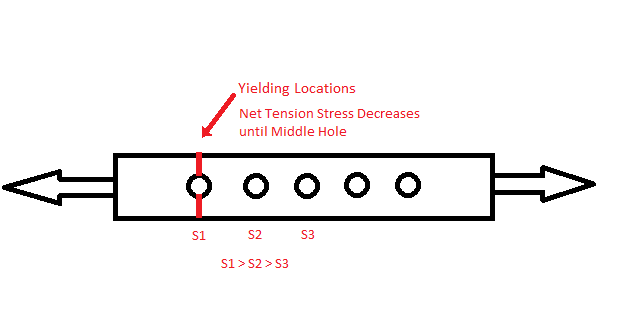

Parent Material of Section BB (please ignore different fastener count)
The since the outermost fastener has the highest bypass load, that net area will begin to yield before the others. Is that localized yielding going to make the fastener at that area more effective in transferring load (less bypass) or less effective?
More typically, long before the onset of net section tensile yielding, you will exceed the bearing yield strength at many of the fastener holes, leading to redistribution of the load evenly hetween the fasteners.

"Net tension" almost doesn't exist in your real structure. Sure, at the two ends of the dblr there is some local net section, but this would yield and the load redistribute away. In the real world it'll never get near to yielding as tension stresses are limited by fatigue concerns.
Yes, dblrs are quite inefficient at attracting load from the skin, (in my experience the stress under the dblr is about 2/3 of the gross stress) but they're all we've got.
