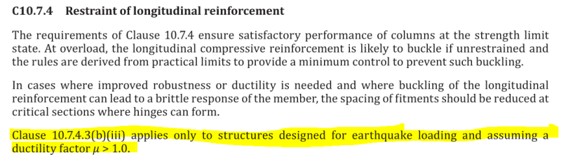

Mu=1
Yeah, there are a couple of things which the commentary clarifies. Interpolation of the tables for fire design of walls is another which is written in the commentary and not the code proper. But overall, it seems to be a very comprehensive and well written document and does seem to be a lot more informative than the previous code commentary.
It is the most we could do until a Code revision is released.
the Lu <= 5D rule applies for OMRF's and IMRF's in section 14.4 and 14.5, so if mu > 1.
10.7.4.3(b) (iii) says it should comply with 14.5.
So you check in accordance with 14.5 and 14.5 says if it requires the ductility level of an IMRF then the special detailing is required.
If mu = 1 then it is neither so the special detailing is not required.
In future, 10.7.4.3(b) (iii) should be amended to say If mu > 1 then 14.5!

It was put into section 10.7.4.3(b) (iii) to remind designers when they are doing the detailing in section 10 that there are specific more stringent rules in section 14 for buildings requiring seismic detailing, as some designers would look at section 10 and say that all that is required is the section 10 rules as they do not mention section 14! And that is the dilemma of code writers!
Yeah, I'm thinking ahead to the next revision but also thinking about the principle of not stating things twice (like we are sometimes told to apply to drawings and specifications). So there could just be a cross-reference along the lines of "The requirements of Section 14 are in addition to the requirements of this section." That could go as the very first clause in section 8.3, 10.7 & 11.7 for example.
