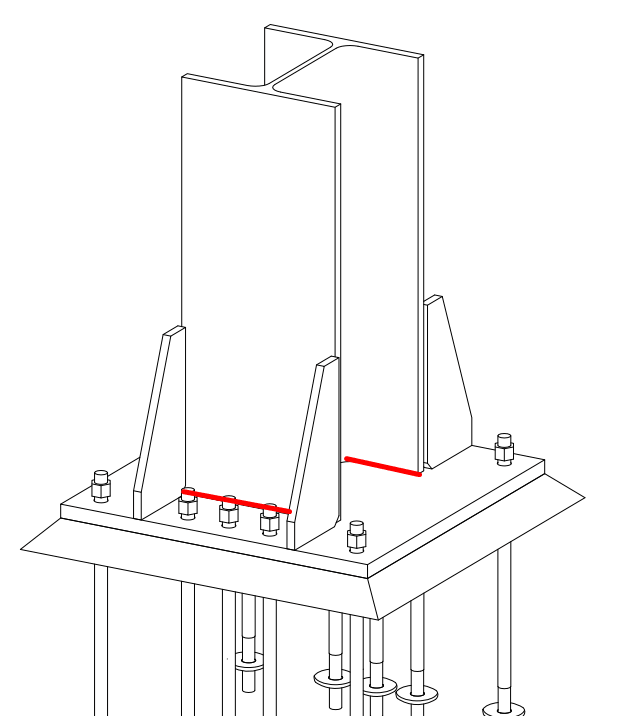

Your reply is extremely helpful. I want to further inquire, if UT OR RT is applicable to T-joint.
dauwerda said:
Is UT applicable to T joint weld as the above picture?It is said that PT is widely used in T joint weld between column flange and base plate.
RT cannot be done with any useful information obtained on the corner joint shown.
Are those welds really spec'ced as groove welds?
I might add that while UT can be performed, you may not obtain useful information unless it is performed by a truly competent and experienced examiner using the proper methods of UT.
weldstan said:
But it is clearly specified in AISC 360-2016 N5.5b that UT is applicable to T joint weld. Here weld between column flange and base plate is T joint groove weld.
Weldstan is correct. UT is doable, but is isn't clear cut. You'll need a decent, approved procedure and an experienced UT operator.
