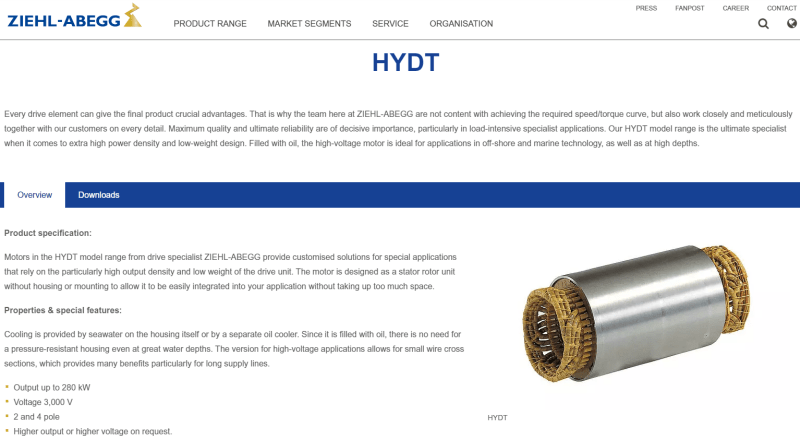

Hi All,
Please let me know of any manufacturer/supplier who sells just stator/rotor assembly only. Basically it will be an oil filled motor housing.
One of my common supplier is Ziehl Abegg. I need some other options please. 100HP and above.
TIA.
R.Efendy

Thanks all for your kind reply. Our application is for underwater purpose. It could end up to 3000mtrs deep. So, we have to design our own housing that could withstand the pressure and fit our purpose.
Also, we have good experience of making the assembly by our self and yes, we normally purchased the rotor and stator as a package.
Disassemble the existing rotor/stator from the on-shelf motor is not a good option as we don't know the original exact dimensions, heat shrink, press fit, other process that the motor has experienced.
We decided to open the opportunity for the other suppliers as we are facing slow response from the common one.
R.Efendy

Ziehl Abegg has this type of rotor and stator unit:
and we have done quite a lot of housings for this type since last 20 years. as time flies, we need to prepare ourself for the worst, can't rely on one supplier.
electripete said:
I'd guess the mechanical aspects will end up the most challenging.
not a problem at all. we have designed the housing and mechanical interface for the rotor and stator.
and all other important element for the interface to the hydraulic pump.
and yes, the motor assemblies survived 3000 mtr water depth.
