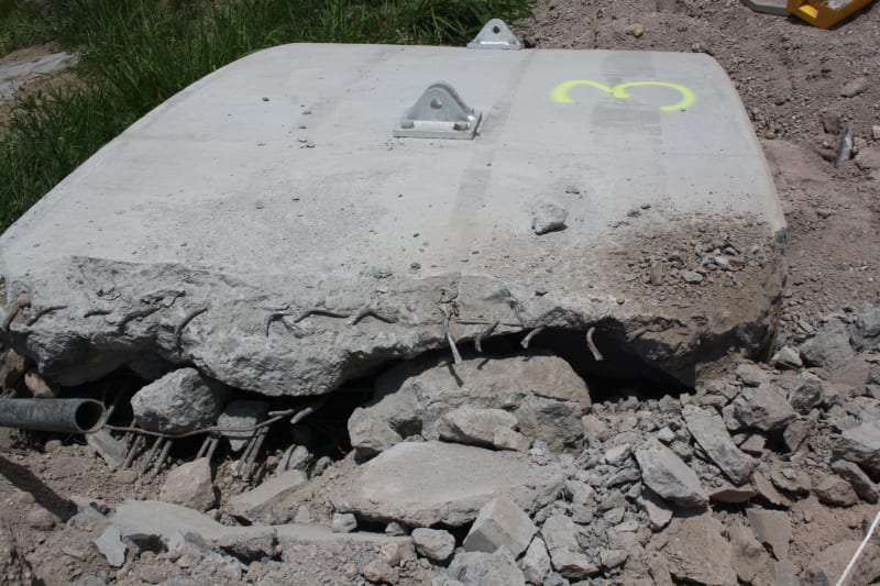

sdz
It is an anomaly that was introduced when someone decided to allow for Class L steel using the Phi factor rather than phi * .85 for the strength reduction. I have pointed it out to them before but got nowhere.
In RAPT, we atually use the ratio of .85/.65 to account for it to get it right.
(M uo)min =1.2 [Z f´ct.f + Pe / Ag Pee]
I always treat that as a requirement for phi.Mu(min), or if you prefer M*min.
The 1.2 factor is an allowance for the concrete tensile strength being higher than the code f'ct, not a substitute for the bending reduction factors.
Here's what can happen if you don't:
