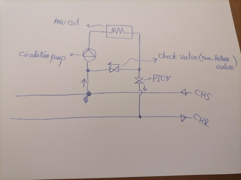

Dear Experts
The photo is related to one of AHUs on the riser. The problem is that only
This circuit has problem of pump cavitation on the riser and other ahu pumps are working fine
When pressure independent control valve is open more the cavitation sound
Willl be higher and vice versa so could you please let me know which part of circuit should i
Check? I my opinion the check valve is faulty but i am not sure and need your idea.

@LittleInch which components should i read pressure from? And whats your suspicion?
No the ahus dont have the same pump capacity but one of the Ahus has coil that is bigger than the one i mentioned but it's pump has no abnormal sound.
The is no obvious sign of not cooling or weak cooling in the AHU.
I want to solve the problem before the pump
become defective.
The coil capacity in the photo is 18 m3/h and duty point of pump is 1.2 bar/ 18m3/h
Pipe diameter is 2 1/2 inch
In higher percent of opening picv valve the cavitation sound become more.

Ideally get pressures at pump inlet, pump outlet, node before the PICv, node after PICv.
Then you might be able to figure it out.
Currently I don't have clue as to why your pump might be cavitating. If your check valve is leaking then the pressure local to the pump might be reduced, but I'm just guessing.
If it is cavitating (and not just failing for some other reason) then either you are operating way too far to the right of the pump curve (more than intended flow) or you are choking the inlet side (blockage or valve not opening).
edit - Or you are trying to pump air + water.
Not much to go on with the limited description.

I also thunk best way to work out what is happening is measuring pressure at the inlet and outlet of the pump to see low pressure at inlet cause cavitation(low NPSH or low dp across pump) and so on.
But something that is very bizarre for me is that the pump is in close loop and changing percent of picv valve should not have any effect on the pump operation but in higher percent the cavitation sound become much more!!!!!!!!!

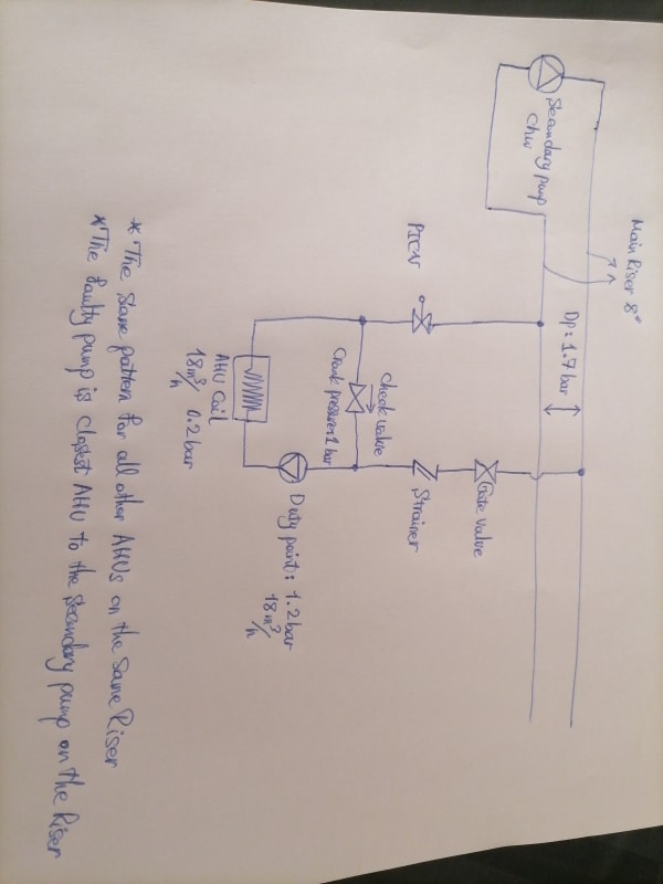

Where in the system is this particular AHU - Can you sketch the whole system and show us where it is reference to the circulating pump of the main header system.

I don't really understand what the pump is there for. The pressure drop through the ahu is far too small for the pump so it is almost certainly operating beyond the curve and has a lot more than 18m3/hr flow.
Try removing the pump and see if it still works...

Yes, but as soon as you open the control valve the flow through the pump will increase.
Also maybe this "cracking pressure" of the NRV is not functioning properly?? If the spring has broken the pressure drop might be <0.1 bar.
Can you just replace the NRV with a new one to see if this is the real problem?
I dont think so by opening the picv valve the flow through the pump is increased.
Pump and coil and check valve together creates a close loop and basically the flow through coil should be always 18 m3/h and only flow at point between picv valve and check valve is changed.
Whatever the picv valve open that amount is taken from the supply line to the loop.
In normal situation pump operating point should has nothing to do with the picv valve position but failing check valve can cause low drop in ghe loop and pump point shift to right side of its curve and can cause cavitation.

You can get a situation where the flow going out from the PICV and incoming from the header is added to the circulation flow. Especially if the NRV has a lower cracking pressure than it should.
All depends on the actual pressures.
But try a new check valve first. It might solve your problem and is easy to check.
I would also check the strainer - a clogged strainer will reduce the pump inlet pressure, such that it is always starved, and runs closed loop - drawing from the check valve bypass. Opening the PICV then starves the pump (lowers the pump inlet pressure coming from the check valve).
Agreed - Just as likely and fits the description of symptoms as well.
So either try them or fit some pressure guages...
