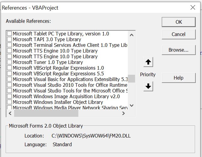

Don't think the new default mail app even supports VBA like this (is there a reference in excel for the app that you can enable, check in VBE under references)?
Quick web search pops up a few older discussions that suggests it is not possible.
Good morning!
Thank you for your replies!
I did look into the VBE under the references but did not see anything.
Closest I saw is shown here in the picture
I did see some older posts like Agent666 mentioned.
Also, I developed a work-around until I come up with other solution. Rather than Excel sending all the HTML
to Outlook email I wrote out the HTML to a file onto users desktop using the " Print #FileNum " code.
From there we can copy/paste; to list, cc list, subject line, body info into a Windows 10 Mail new mail.
I know this is kind-a awkward but.. It will keep things moving forward until we find a better solution.
Thank you!
