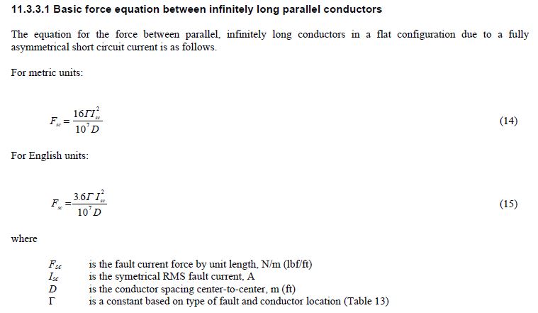

Here is the basic force equation from IEEE 605:
These forces are typically only considered for rigid bus (not for strain bus or flexible jumpers) and the force acts transverse to the length of the bus. Essentially the different phases of the bus are either attracted to each other or repelling each other. Typical values for these loads that I see in design can be anywhere from essentially 0 to 100 lbs/ft of bus or more. If you have a 3 phase bus support only the insulators and top beam will see these loads as they are opposite and cancel each other out (so it's not very impactful on the structure design). However, if you have a single phase bus support, the load will be transferred all the way down through the structure to the foundation.

phamENG said:
I thought that was typically provided as a reaction from the EE as part of the line and bus design?
My experience is that the structural and EE have to work together on this. The EE is really only concerned with having large enough bus to carry the current safely and efficiently, they aren't necessarily thinking about the structural aspects. I have also never had an EE do the calcs from IEEE 605 for me, they would only ever provide the short circuit design force (and some other parameters referenced in IEEE 605 such as the X/R ration) to use for each particular substation. Often, the bus span is limited by the strength of the insulator. For subs with large fault currents possible I have had to use two (high strength) post insulators at every bus support just to get spans long enough to accommodate the bus layout. I have also had to increase bus size from 4" to 6" for the same reasons.
