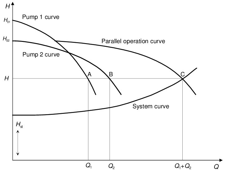

Why dont you google "parallel pump curve" and look at pictures? this illustrates it pretty well:
[URL unfurl="true"]https://res.cloudinary.com/engineering-com/raw/upload/v1645600113/tips/Parallel-operation-of-pumps-1-and-2-points-A-and-B-and-thee-resulting-operating-point_fig3_257768330_upr0ms[/url]
Parallel-operation-of-pumps-1-and-2-points-A-and-B-and-thee-resulting-operating-point_j2ef86.png

FYI, The approach MortenA posted is much simpler, but also relies upon the losses in the suction line and discharge line up to the tie-in point for each pump are either similar to each other at all operating points or are negligible compared to losses after the tie-in point (as seen by the existence of only one system curve).
You could check max expected flow through each pump, and if losses before the tie-in point are less than, say, 5% of total losses, you could move forward with the approach he suggested with assurance of reasonable accuracy.
