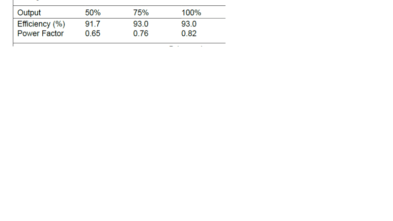

I took the motor efficiency(93%) and Power Factor(0.83) from the motor nameplate. I don't have the PF vs. Load curve. I will ask these from the pump manufacturer today. The motor is rated for 30HP. The FLA of the motor is 28.6 amperes. We are measuring 28 amperes at the flow we are measuring. The motor is rated to work at 575 volts. Initially we doubted if the correct size impeller was installed. To rule this out I measured the pump shut-off head by closing the discharge valve on the running pump for a short duration( less than a minute). The shut-off matched with 10.3" impeller the one installed by the vendor during our purchase. We measured the flow using a portable Ultrasonic flow meter and measured a flow of 1630 US gpm at 37.29 feet differential head. The flow rate as per the pump curve for 37.29 ft differential head is 2450 US gpm. Since the flow meter can be in error, I used the power calculation methodology to calculate the flow rate. I calculated the flow rate as 2161.5 US gpm, still short of 2450 US gpm by 288.5 US gpm. We need to know the reason for this difference. The pump vendor who inspected the pump said that smaller pump suction line could be the problem. The pump suction line is 10" We know it is supposed to be 14", which we will replace during a one day shutdown. The pump is not cavitating with NPSHA is 50 ft when the NPSHR is 11 ft. I seriously doubt if the 10" line size ( which I admit is not correct size as it was installed before my time) is the real problem. I will do pressure drop calculation on the pump suction side today and check how much we are losing. The higher the loss higher the differential head and lower the flow delivered by the pump. Let me know your thoughts. The reason we are so worried about this pump is that it is feeding the shell side of a product condenser after being cooled through a Cooler which is underperforming. We think we can enhance the Cooler's performance by increasing the flow rate of this pump which is on the shell side of the cooler as the shell side is controlling.

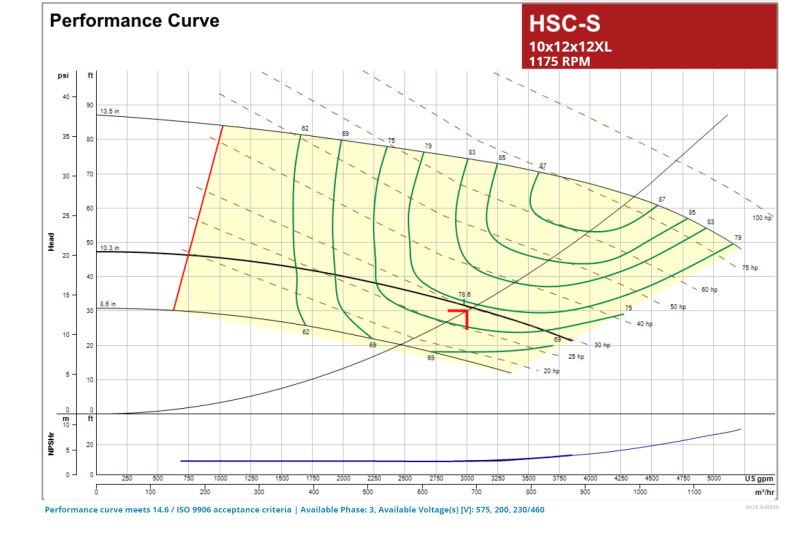

 https://files.engineering.com/getfile.aspx?folder=072098f0-9303-4519-90e4-8ece4430cca9&file=Pump_Curve.pdf

Thanks for supplying data.
If you didn't ask for a performance test I doubt there is a specific one for that pump.
However some comments on it
1) It doesn't show efficiency or Power curve which is usual - search the documents you've got for your size impellor to see if its there.
The motor looks right on the limit and with a FLA of 28.6 you are at 28 so not much room for more power there...
2) There is what looks like a system curve? Thin black line which seems different to reality? That seems to be how someone got the duty point of 3000 GPM
Your motor is only just about sized for max flow (98%?). Someone has really cut this pump and motor to the bone.
Efficiency
The single data point provided is at 3000 gpm and it's 79.15% It actually say BEP is 2876 so that could be nearly 80%
At your flow rate of 2450, I would estimate therefore that efficiency at 2450 to be at least 76%, not the 70% you used in your spread sheet unless you've got more data than you've let on.
Using 0.76 as efficiency I get 2350 GPM so only 100 GPM adrift.
That's well within the 3-5% accuracy of standard pump curves.
SO I don't think you have an issue with the pump
I also don't think you've got much spare in the pump before you trip the motor.
But yes - your 10" suction line is too small. At least 12" and pref 16" might give you a bit more flow without overloading the motor.
So as usual in these instances, there is nothing wrong with the pump, but you have some other losses which were not allowed for when choosing the duty point of the motor. Find those flow restrictions and you will get more flow. but watch those AMPS!

1) It doesn't show efficiency or Power curve which is usual - search the documents you've got for your size impellor to see if its there. Sorry I did not supply you the pump efficiency curve. Please find it attached. I adjusted the pump efficiency as I increased the flow rate for iteration. I efficiency at 2166.5 gpm flow rate is 70% which is what I used.
Yeah then the question is why is the pump not delivering the required flow, which is what I am doing to calculate the flow rate with equating shaft power and motor power. I also got the PF vs. Load data today from motor vendor.
2) There is what looks like a system curve? Thin black line which seems different to reality? That seems to be how someone got the duty point of 3000 GPM.
I do not know how they plotted the system curve. I am going to plot one myself by doing the system hydraulics today.
The motor might have been selected for the max flow it is supposed to deliver which is 3000 US gpm at 30ft diff. head. With increase in system pressure drop mainly due to increase in pressure drop across the heat exchangers in discharge side due to fouling the flow has dropped. I am going draw the system curve by performing pressure drop calculations of the system today.
Efficiency
The BEP is 87% efficiency between 3500 and 4500 US gpm. We are operating way below the allowed between 80 to 110% of BEP.[/color
Using 0.76 as efficiency I get 2350 GPM so only 100 GPM adrift. As you can see in the attached pump curve the efficiency is only 70% at 2166.5 US gpm. To get 76% efficiency we need to operate at 2500 US gpm, which are not able to do.
I also don't think you've got much spare in the pump before you trip the motor. I am still not sure.
But yes - your 10" suction line is too small. At least 12" and pref 16" might give you a bit more flow without overloading the motor. I will get pump suction line changed to 14" at the next shutdown and see if there will be any improvement. I seriously doubt it will.
Yes I agree. I want to unlock by performing the system hydraulics today. Yes I will keep a watch on the AMPS.
We must have posted at the same time - Nothing was attached to your post though
I think you did the calculation the wrong way around.
Look at the head difference. That gives you the flow the pump is supposed to be doing. That gives you the efficiency at that flow (2450). That matches the power going in.
So there is nothing wrong with the pump.
If there is fouling on the HX or extra pressure drop in the inlet line then the flow will drop as the differential head rises.

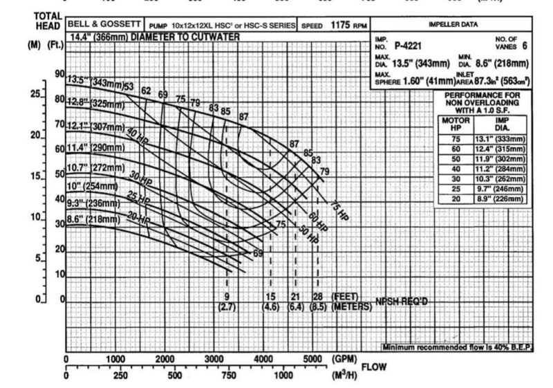

The Head-Efficiency- Flow curve I posted for this pump is little different from the one you posted above. Our current Diff head is 37.29 ft based on suction and discharge pressure gauge readings. From the pump curve the flow should be around 2450 US gpm and efficiency at 76% and power around 28 HP. The shaft power calculated with the current load is 28.82 hP. If I put these numbers then the flow calculated by matching shaft power with electrical power supplied by motor is close to 2450 US gpm. I manually changed the pump efficiency as I iterated the pump flow rate. It looks like I did not enter the pump efficiency correctly and that is what lead to the difference in the flow. Is there a way I can get Efficiency vs. flow in tabular format? Can the pump vendor supply to me? I always wanted this.
I can use it to iterate the flow correctly next time.
From this exercise I see the pump is flowing 2450 US gpm. When we measured the flow the flow meter measured 1630 US gpm which looks like it was way off. Since the power consumed is matching with the flow rate of 2450 US gpm, I will consider the flow delivered by the pump us 2450 US gpm. I now tend to believe that there is nothing wrong with pump. I will check if I can put a bigger motor with higher RPM ( of 1800 RPM ) against the current 1200 RPM to get more flow. We will also install a VFD to control the flow as per our requirements. I first got check with pump vendor if the pump can support 1800 RPM motor.
