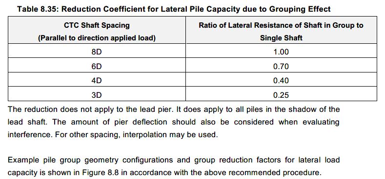

Working on Pile foundation substructure. I have determined total lateral force in X and Z directions acting on the group of piles.
Was provided 1" deflection and 3" deflection lateral resistance by Geotech with a P multiplier of 0.8. Is it Geotech's responsibility to incorporate the correct P multiplier in the L pile based on pile layout? I think based on the layout and AASHTO table, the p multiplier will be less than 0.8 for my layout.
1st question - Can I take the avg. P multiplier for Row 1 and 2, provide it to Geotech and then compare the resistance of a single pile provided by Geotech against a load on the single pile?

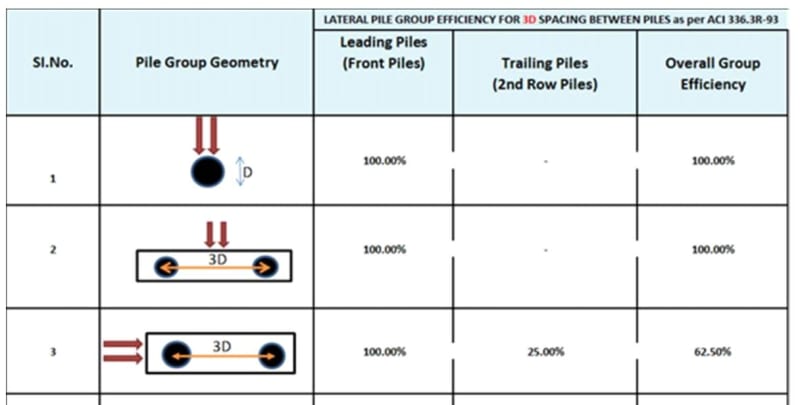

The P multiplyer of 0.8 for lateral capacity is too high. For 24 inch pile, you are at a 108/24 = 4.5D in long direction and 2.5D in short direction.
Therefore your P multipliers should be 0.35 and 0.2, approx, respectively. Its the geotechs responsibility, but if you notice something wrong its your responsibility to highlight it to them.
And yes, you can take overall average of group efficiency.
