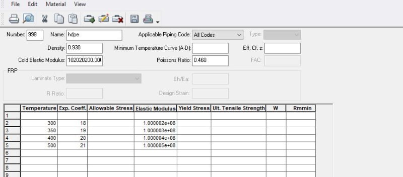

Hi experts,
I am new to CAESAR II and I have to model an HDPE pipe, when I add new material to database for trial purpose (later I will enter exact values) it shows ERROR 1E, can you please look at the data and guide what I am doing wrong?

It may be a dumb question on my part, but would defining the properties on the first line help (rather than starting on line 2)? Been a while since I had to define custom CAESAR materials.
RE: ERROR 1E CAESAR II, MATERIAL DATABASE
I believe you should have a hot modulus of elasticity value at least i.e. non-zero.
Thank you littleinch, novastark, kevinnz and engrpaper for your valuable replies. @abdulmaleki1975 yes, we do use it for buried pipeline as well.
