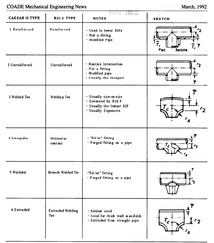

1) Are you using later versions of the program where its calculating SIFs per B31J? Or are you working on an old system using the old appendix values?
2) If the pipe input parameters (size, schedule, intersection type, etc) match, the SIF scratchpad should calculate the same value I think? I've largely only used that to gut check if changing thickness/intersection type would resolve the stress issue. In your screenshots the type is unspecified - is it unreinforced/fabricated, extruded, what? Your last screenshot appears to say its a 12" olet on a 28" pipe, I just don't buy that's the real scenario.
Here's an image from the old Coade articles that may help you pick the appropriate intersection type if you don't know.
Lastly, at these sizes, its very possible regardless of your intersection type that Caesar will be overly conservative. This is because Caesar II is not FEA , everything is just a stick with varying degrees of stiffness. If you go thru everything and still have stress issues, you may need to run an FEA analysis on this intersection to get real stresses.

I think what happened is as follows:
When caesar calculated the SIF as in the first screenshot at top it considered the element from the 8683 to 8684 to be a massless rigid element. Modeling in this way accurately put the location of the stress intensification at the surface of the pipe and eliminated the pipe section between the surface of the pipe and centerline of the pipe. This method of modelling is described in the attachement of my previous post. This is why it is of a goldish color and why on the stress output sheet there is no stresses shown for that element. Stresses are only shown at the end point of the element 8684.
When you modeled it I believe you modeled the element between 8683 and 8684 not as a rigid element but as a regular pipe element. You can see that the color is blue of this element on your screenshot and that on the stress report there is now stress values given for this element which indicates it is not modleled as a rigid. This form of modeling changes the stress values since it adds 14" of extra pipe lenght that really does not exist between the surface and centerline of the pipe.
If you redo your calculation and change the element 8683 to 8684 as a massless rigid the results should come out the same.
