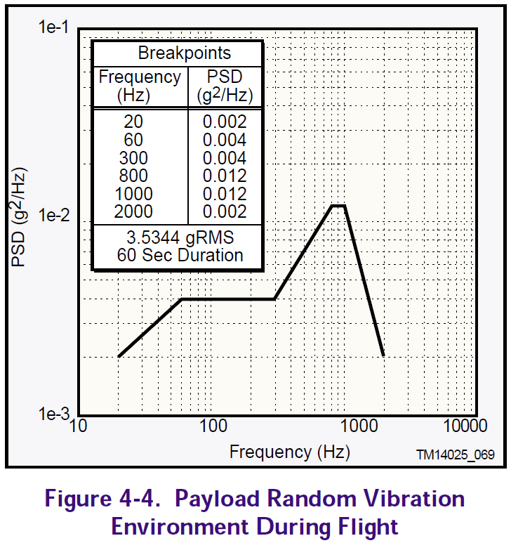

Hello,
I notice the acceleration and grms given by the launcher OEM are increasing with frequency... in my prior experience in the interior design, acceleration is higher at lower frequency...
It is interesting to see the difference here but I am wondering the physical meaning why higher frequency higher acceleration?
Thank you!
vibration means displacement. displacement in a sinusoidal wave means if your amplitude is fixed then higher frequency will mean higher acceleration. Maybe in your previous experience higher frequency meant lower amplitude ?
You need to pay attention to the frequency, and look at the total curve; all vibration must eventually start to decrease in amplitude, since displacement cannot continue to increase with frequency. The below is from the Minotaur user's guide

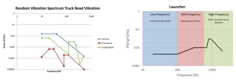

In the interior design, the amplitude started with higher g then decreasing but now for s/c, it is increasing ...
The PSD is measured to represent the actual event, right?
AFAIK, the PSD is showing the distribution of cycles in the spectrum.
in a period of time there will be X cycles. X/1000 will be at the load level of 1000 Hz, X/100 will be at 100 Hz.
I am attaching a picture for reference...
what can we say ... vibration in a rocket is different to that in a truck.
Yes - this is saying that there are higher high-frequency accelerations than the accelerations at lower frequencies. Considering that low frequency means higher amplitude to gain similar accelerations ask what happens to a rocket or an airplane if it is experiencing high amplitude low frequency - think Tacoma Narrows Bridge.
You are literally comparing a truck to a rocket; trucks have suspensions that attenuate higher frequencies beyond around 2 Hz. The truck would be otherwise not fit for human ridership, since you could possibly ride such a PSD for hours, while a rocket's PSD lasts about 10 minutes

Your misunderstanding is in thinking that the phenomenon are related; they're not. Automobile vibration is from rolling on the ground with a suspension; rocket vibration is from instabilities/inconsistencies in rocket fuel combustion coupled with aerodynamics variations. There should be zero expectation that the PSDs would be at all comparable. For example, a car can't generate much more than a couple of g's in non-braking straight line travel, while rockets routinely exceed 6 g's in liftoff. They have a 200:1 ratio of velocities.
