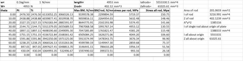

I became restless and took myself through the pain of calculation. Here is my calculation. Yes, you are correct if you are getting extraordinary stress if you have calculated considering each rod separately. I added crude calculation considering 4 rods together and finding moment of inertia of all rods.
Some points-
-At 0deg, entire beam will be supported and we would not see any of the stress calculated above.
-As we go on lifting till 90deg, we will see range of stress due to change in θ.
-If we assume all rods together support the bending moment then calculation shows lift can be safely done. (Since the 40mm thick plate will apply the BM on all 4 rods simultaneously)
-If all rods will not be supporting collectively (which I doubt), then you have problem which can not be solved by 2 point lifting. May be bigger rods or more lifting points need to be considered.
-Considering the offshore lift will involve dynamic amplification factor (DAF), even if we consider all rods taking the BM together may result in high stress which I have not included since I do not know the DAF. Check that yourself. If that is the case then you may need to resize the rods or provide more lift points/supports to avoid unsafe lift.
-You may need to check the rod thread shear or thread integrity separately.
I hope my calculations are correct and the pain is worth the gain. [smile]

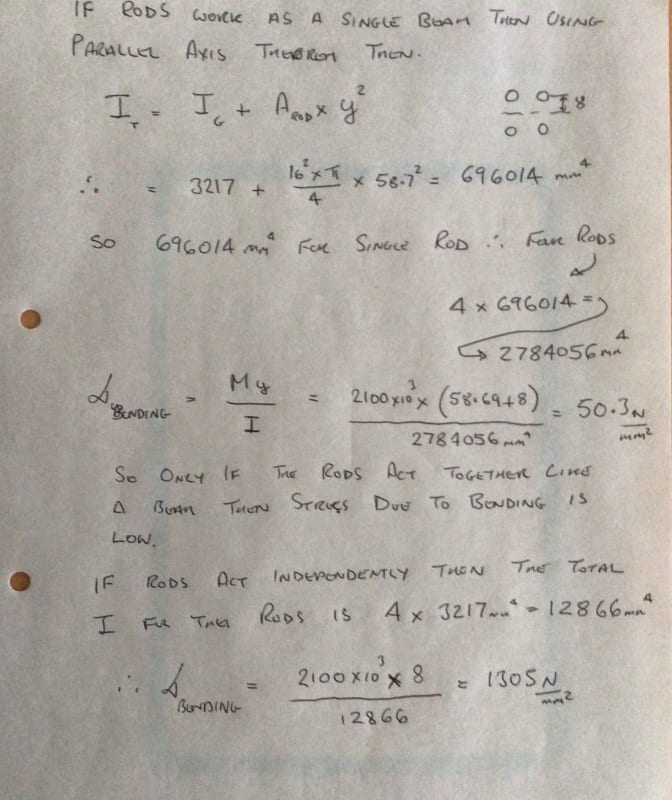

I have my feet in two camps here lol, according to my calculations I agree with NRP99 in that if the four rods act as a composite beam then yes the lift would be safe and on the hand I agree with HTURKAK in that if the rods act independently
then the stresses will be high as his calculations show. Do the rods screw into the spacer plate from both upper and lower side? I presume they do. My gut feeling is that you would get composite action if the spacer plate and the rods are tightly assembled however I wouldn't take that risk if it were my job, I would find a better way of lifting it, why can't it be lifted in two sections and then assembled?
I would also add that I haven't looked at any shear stress on the threaded rods due to the bending action or the tensile loading as the lift progresses and it might actually be the shear stress on the threads where it connects with the lower assembly that becomes the Achilles heel.

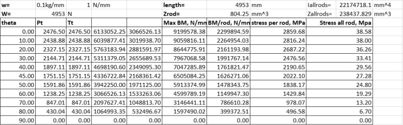

Ok my bad. I have done silly mistake in calculating section modulus of rod and the entire calculation needs to be revised for that mistake. Found that after checking the calculation by HTURKAK. Done in haste so may be I need to sit down quite away in sound proof room to achieve the kind of excellence shown by HTURKAK. So here is revised calculation with my approach of assuming simple supported beam with UDL of w/length.
Some points and questions-
-I am getting way high stresses than the HTURKAK, which I do not know why. May be I am doing something terrible which I am not able to pinpoint. Any pointers to look for?
-May be you can use more spacer plates at entire length of rods equally spaced left and right of current plate. This will ensure the middle section becomes stronger and can resist the lifting forces. Just a suggestion.
-Question - How to achieve the excellence of doing simple calculation as shown by HTURKAK? Any suggestions?

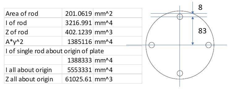

NRP99. Can I ask how ‘Z’ values and ‘I’ values are calculated for all 4 rods as a system? I’m sure what you have calculated is correct, but I am having difficulty following your calculations.

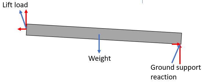

@NRP99 ...
1) "So the assumption of rods taking all the moment is correct one" ... if you don't mean bolt moment = beam moment /4 ? the fasteners couple carry the beam moment in pairs as couples.
2) I don't a UDL is the correct loading for a lift. UDL for weight and the lift load at the LH end. This makes the beam "difficult" to solve, what's reacting the moment due to the lift and the weight ? do you lift with a strop, a sling attached to both ends, so the lift point is always above the CG ?
Here is what I done- Considered the rods placed as below (which is not ideal placement, I think). Then calculated inertia of 4 rods together with parallel axis theorem about the center of plate.

draw a free body of the lift, starting at zero, then at say 30 deg, 90 is trivial (except maybe for were the beam ends up relative to its original position).
if you lift from the LH end, then the beam will translate to be under the lift at 90 deg. How it moves at intermediate states is a question. Does the LH end rise vertically and the other points track as the beam rotates ? What does the free body look like at 0.0001 deg ? If the lift is vertical, and weight is parallel down, how is the offset moment reacted ? It's possible that a "small" horizontal reaction can be applied through the lift point, inclining the lift vector. Remember this beam is a simple three force member (review if needed to understand what this means)
If we lift a beam off the ground, I think we don't apply a vertical force, but an inclined one, thus a horizontal couple reacts the offset moment.
If you lift with a sling, you can move the lift point and keep it close to the CG of the beam (so you're lifting above the original CG position, not the LH end).
clear as mud ?
- If the rods are not connected to each other ( to get combined behavior , at least with diagonal elements like truss) , you can not assume the rods will behave as combined and you can not calculate the combined moment of inertia ..
- In this case the four rods will resist as separate elements
- In order to assume group reaction is valid, the rods SHALL BE connected with web elements . The beam theory ( plain sections will remain plain after deformation ) is valid for composite elements when they connected to each other to transfer shear..

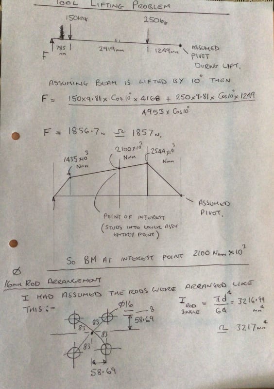

Hi rb1957
I am not understanding how you are approaching this problem but that isn’t to say that you are incorrect, however I have put pen to paper and have laid out my process thoughts and my results are very similar to Those of HTURKAK, I guess it all hinges on how the rods act ie as a unit or individually 👍
Here is the second image of my calcs
