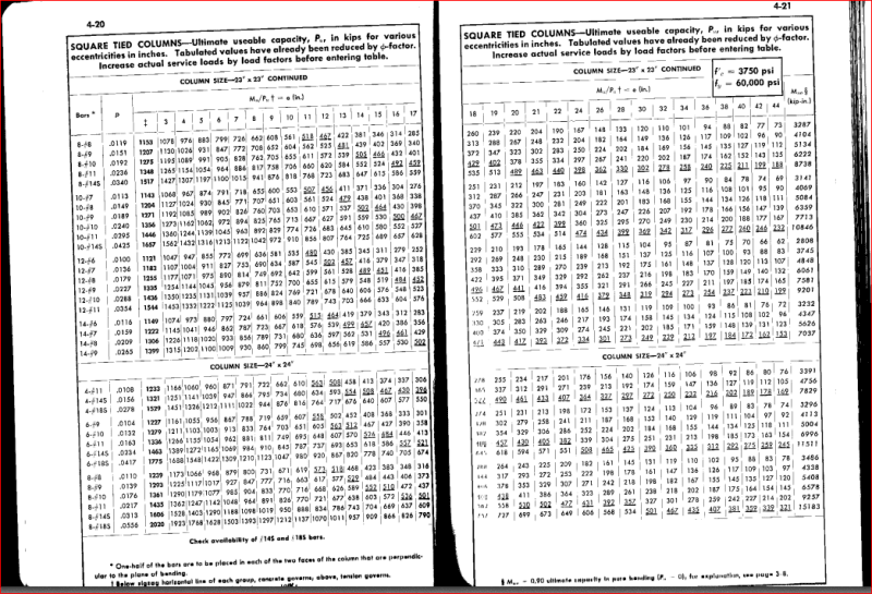

The snip below was taken from the CRSI publication "Columns by Ultimate Strength Design", prepared by R. C. Reese, copyright 1967. Some might say it's a little out of date, but the same document is available on ebay today. At that time, 4-#11 in a 24" x 24" column was permitted.
Actually, the table goes even further, with the largest square column listed as 40" x 40", reinforced with 4-#18S bars.
BA

There may be some validity to that opinion. I come from an area with virtually no seismic activity. However, it seems to me that if that is a valid concern, one would think it would be spelled out a little more clearly in the ACI and NBC codes which, unless they have changed recently, do not have a requirement for more than 4 bars. If such a requirement now exists, it must be followed.
Edit: By the way, vertical bars do not provide confinement to the inner core of concrete. In fact, they need confinement themselves, which is provided by the ties.
BA
