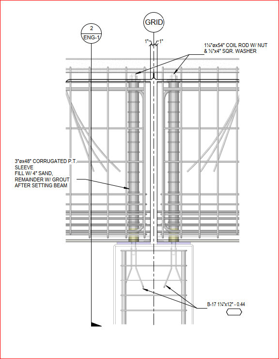

Since this is a precast column, a certain symmetry will be lost if the column is cast in the horizontal position. Concrete will settle under the upper 2-#11 bars, leaving a gap below each bar. When the column is erected on site, bars on one side will have poorer bond than those on the opposite side. I don't know whether or not this could result in a significant difference.
You'd always need to consider the orientation at which a member is poured when determining splice lengths. There is an increase in splice lap lengths in most codes to cover this.
Agent666,
But in the present case, there are no laps. The vertical bars are all of equal length. I wonder if the bars which had been on top during casting, would feel the applied load at a different rate than those which had been on the bottom. There is imperfect symmetry in the column which may tend to make the "pin" less perfect.
I don't believe so, in my opinion it wouldn't be something I'd be too worried about (nor ever worried about in practical design sense).
High bond stresses are only really a consideration for splices where the trapped air bubbles you've alluded to impact development length. Development length in compression may factor in this scenario, but there is obviously enough length over a full storey, the actual bond stress would be the same on the 'bottom' and 'top' bars, and obviously below the capacity in ultimate limit state design. OP can comment on what the bar stress actually is under their compression loads, I bet nowhere near yield in pure compression though where bond is an issue?
I don't personally think it's that great a pin until you fail the slab over at least, as beam rotates under load to act as a simply supported beam it just attempts to rip slab apart in the gap I would have thought. Start cycling it back and forth under seismic and the shear in slab through the gap will obviously cause the slab some distress/damage. The sand is potentially likely to be a durability issue long-term depending on how protected this location is from weather. If a carpark for example, a nice big crack in the slab and lots of water trickling through and wicking into the sand and you've got some great conditions for corrosion of those through bars.
You have to wonder generally if a 'good' pin in one direction, how pin like is it in the other direction (I'm assume 2-3 bars probably here across beam width here to make it less pin like in the orthogonal direction), and whether this results in some concerns regarding the stability of the system as a whole.
If a 1200WB with 9 bolts is a pin, I'd accept this as a pin.
