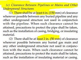

Hi experts,
Is there any clearance specified in B31.8 (Gas Transmission and Distribution Piping Systems)for two buried pipelines? I can find the clearance between buried pipeline and underground structure (image attached) but unable to find clearance between two buried pipelines.
Thanks in advance

Another pipeline can be regarded as a structure in this instance.
Most of the time you are limited by the other pipeline owner and his legal rights.
300mm is the smallest usually and 500mm very common.

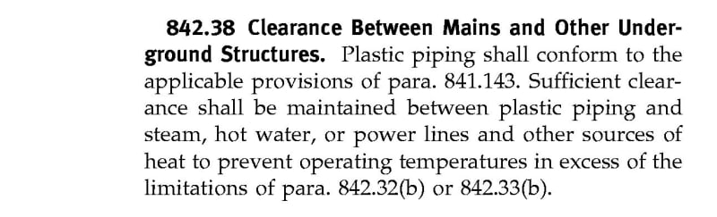

I have 2003 Edition. The clearance requirements for plastic piping,
and Para. 841.143 is for steel piping and excerpt at your post.
So , incase of pipeline , min. clearance 150 mm and for gas main 50 mm.
You may look to the definitions of gas pipeline and ( distribution)gas main.
