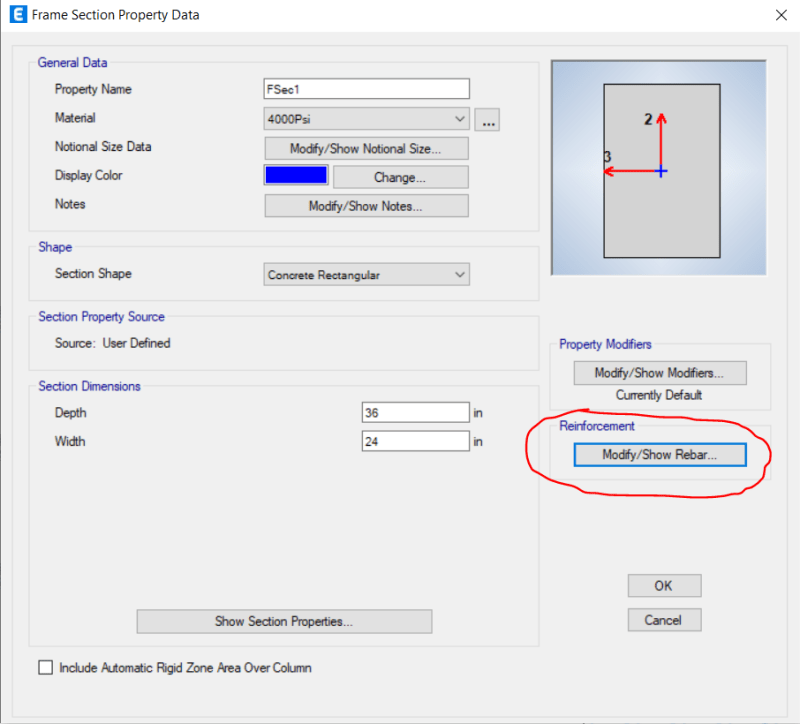

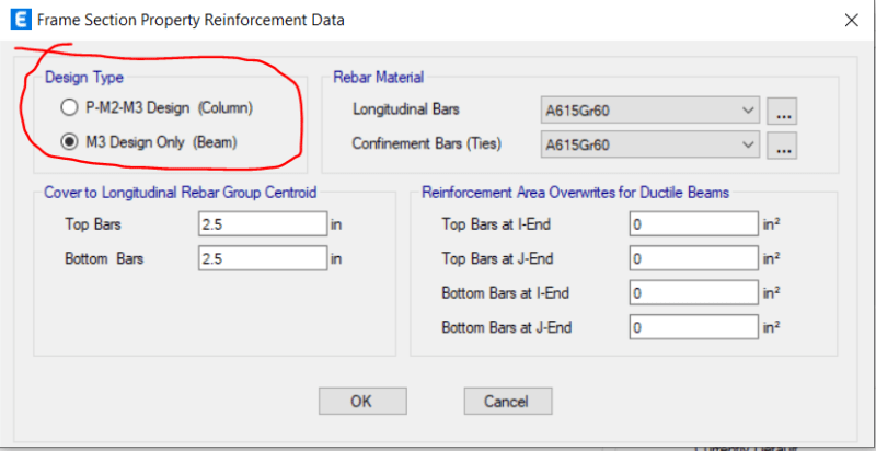

Is there anyway to overwrite the design to become column design ? I have assigned column at the designated location. However, it turned out that some of teh column design becamne beam design. That's weird , is there anyway to overcome this ?
What kind of members are you talking about?
Concrete? Steel?
If you're talking about steel, I don't think calling the member a column or beam should make any difference to the normal code check. Unless you're doing some seismic detailing checks on the member.
For concrete members, the member type (beam or column) is determined as part of the frame section properties. Specifically part of the Reinforcement properties. See images below:
