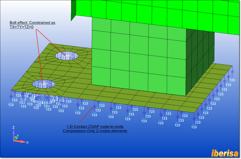

In my blog I explained in 2011 how to perform a normal modes/eigenvalue analysis (SOL103) of an assembly considering both surface-to-surface NO-PENETRATION contact and 1-D CGAP node-to-node contact elements, simply using method-1 via STATSUB:
In situations where contact "no penetration" effect (not boundary condition, please!!) can play an important role in the results of a linear static analysis then I include the effect in the FE model. For instance, here you have the "ground effect" in the base of a tank bolted to the ground. If not considered the contact effect all loadings gets transmitted to the ground only by bolts, that is more conservative.

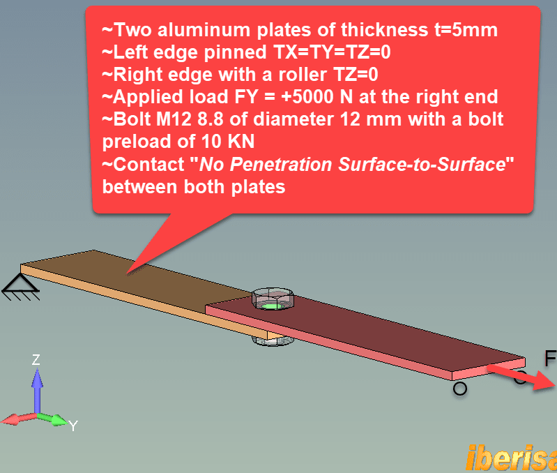

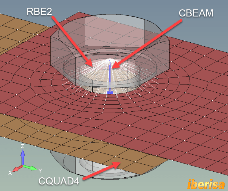

Also "because the pressure of the market" to explain how to consider the contact effect in preloaded bolted joints when performing a modal dynamic frequency response (SOL111) with FEMAP & Simcenter Nastran here you have a simply problem of two contact plates explained how to solve in my blog of FEMAP & Simcenter Nastran:
