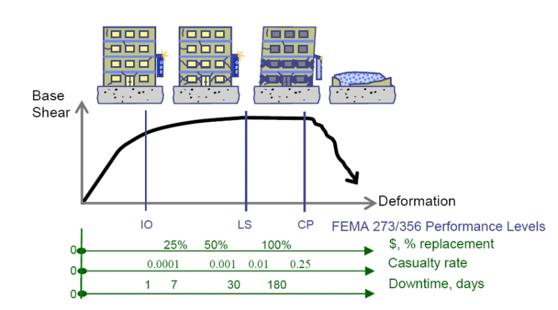

If you write seismic performance levels and search , one of the outcomes FEMA 273 performance levels..
The picture depicts also replacement , repair cost vs performance levels..
You know P58 and ASCE 41..
I will suggest you to look ACI 369 and NIST GCR 16-917-40
When a RC special moment frame , subject to seismic event, the expected mechanism SHALL BE at least Intermediate mechanism (Figure 3-1. Design of special moment frames aims to avoid the story mechanism ..) and if plastic hinges develop at all probable beams , the structure is around collapse prevention level and the option is , demolish and construct new..
If ( say for the fist three storey beams of a ten storey frame ) 10 % of beams yield and hinge develops, still 90 % still elastic and the bldg could be occupied after small repairs , so the full potential is not exhausted..
