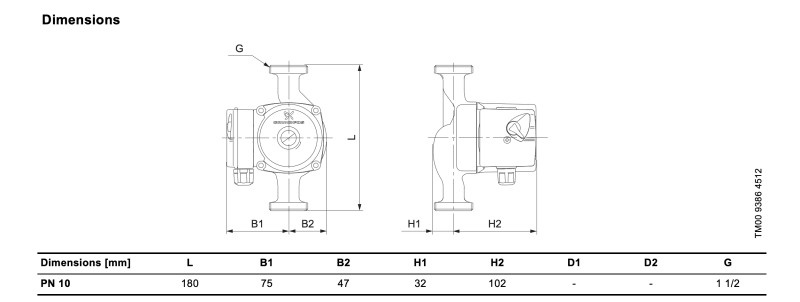

Hello guys. I've asked this question about a previous pump I had, but it was not good for the job. I'm going to purchase Grundfos UPS 25-62 180, after consulting with the company which manufactures the coolant I'm going to use. They recommended changing all EPDM rubbers in this pump with Viton, as this coolant will cause EPDM to swell and leak (the coolant is expensive!) How can I determine the size of the gasket and o-ring in this model?
The o-rings are likely to be a standard size any gasketing will have to be custom cut. You may only be able to get a gasket that fits from the maker; they may have that as an option.
Have you ever thought of asking the manufacturer as it will also include the mechanical seal.
Hello.
I've asked the manufacturer, looked at their spare parts (they only list gasket no sizes), I even asked a store speazlied in making gasket and o-rings, no luck with all.
However, In their datasheet, the dimensions are as follows:
Can you guys help me figure out the circular dimensions, the gasket rests just behind it. I thought I'd take B2 and double it: 514x2= 1038mm. Reasonable?
Can you let us know the coolant you are running? Many engineers or... salespeople will specify Viton as a panacea but if your coolant is water based EPDM will likely provide the best life. If you're using an "oil" based coolant than you'll certainly need to make the change.
If you do need to make the changes, order the parts new from the manufacturer (they won't be very expensive for a pump this size) and use the new parts to make measurements or send to your local gasket supplier to cut gaskets.
If you're in USA, I have a local shop that will make a CAD drawing of your gasket for $25-50 and then can cut as many as you need for a low price.
You can also substitute anaerobic sealants and gasket tapes for cut gaskets.
Hi Tug, The coolant Bitcool, it's definitely not water-based. These changes are a must. I think it's safe what you said. Thanks
The SDS is very vague but due to its slightly flammable nature, no oral toxicity, and low conductivity I would guess the coolant is undiluted propylene glycol in which case EPDM would be ideal. Viton is equally suitable.

Here's a PDF that contains a section view and BOM for the pumps. EPDM appears in the main gaskets, thrust bearing retainer, and the ball of the non-return valve. Section views are on sheets 11-13 of the document.
