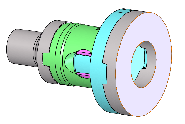

Dec 17, 2021 #1 JFmech Mechanical Joined Dec 17, 2021 Messages 3 Location US I would like to use half symmetry in a FEA model to cut down on simulation time. I an applying torque to a shaft. Does the torque value need to be half as well? Thank you!

Dec 17, 2021 #2 FEA way Mechanical Joined Nov 13, 2018 Messages 5,193 Location PL It depends how you utilize the symmetry. Not all forms of symmetry can be used in analyses involving torque. Can you attach a picture of the model ? Upvote 0 Downvote

Dec 17, 2021 Thread starter #3 JFmech Mechanical Joined Dec 17, 2021 Messages 3 Location US This is the model. Upvote 0 Downvote
Dec 17, 2021 #4 FEA way Mechanical Joined Nov 13, 2018 Messages 5,193 Location PL In this case symmetry can’t be used due to the nature of loading (unless you simplify the model to apply cyclic symmetry). Upvote 0 Downvote

Dec 17, 2021 Thread starter #5 JFmech Mechanical Joined Dec 17, 2021 Messages 3 Location US Ok. Thank you for your help! Upvote 0 Downvote
