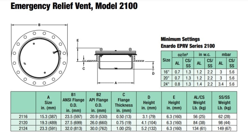

I am working on sizing an Emergency Vent [EV] for an API650 atmospheric storage tank built using API 2000 standard. I understand that API 2000 gives guidance in terms of capacity required for the EV. However, after I am done sizing the EV (per API 2000), next step is to determine the right pressure setpoint to set the EV vent at. My question is: Do I need to consider snow loads that might hinder the EV to open properly when determining the right setpoint? The EV is exposed to atmosphere and does not have any cover over it. I would really appreciate if I can be directed to the relevant standards and practices that are followed in the storage tank design engineering community for such a scenario. Thank you.
Specifically, what type of roof is on the tank ?
What type of EV are you considering where a coating of snow would affect operation ? (be specific, show a drawing or sketch)

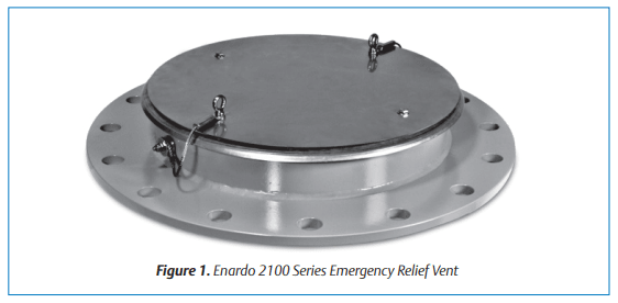

What type of EV are you considering where a coating of snow would affect operation ? (be specific, show a drawing or sketch)Similar to Enardo 2100 series EV. Attaching a picture of the EV we have right now. Since it is exposed to atmosphere att he top, I am not sure if we need to worry about external snow loads in this case.

 https://files.engineering.com/getfile.aspx?folder=468795c9-3464-4e1b-8e0e-ec60627eb4bc&file=Enardo_EV.PNG

Not sure anyones considered that before now. If the activation pressure is impacted by the weight of snow on the top plate then yes - you've got an issue.
So you need to either provide a cover so that the snow doesn't land on it or use a different emergency vent.

These seem to be very simple lids which seal under self weight.
Looking at the picture below the weight of sat 4 " of snow on top of the middle unit could be up to 25kg - a significant increase.
I think you could build a snow shelter but the question of icing up might be relevant as well.

Determine how much the set pressure is raised by the snow accumulation. Fire is an extreme load, so don't combine it with full roof design snow load. Perhaps 25% of the roof design snow load, but it's a judgment call. Since API allows the emergency relieving pressure to be calculated with no wind (clause 5.8.5.3.a) they accept not combining other design loads with the emergency fire case.
Next look at the vent flow capacity curve to see if the higher set point pressure will still allow the vent(s) to reach the relieving pressure and thus the required API 2000 venting rate. Since the flow rate typically jumps very quickly above the set pressure I would hope this would be the case, unless you have a very tight range between your set and relieving pressures and the extra snow uses this up.

Just to point out more clearly- in the event that you do have a bunch of snow on a tank engulfed in an inferno, the effective setpoint of a lifting-cover vent would be increased, but the pressure rating of the tank would also be temporarily increased by that same weight of snow across the roof area.
From my fairly basic calcs it looks like the pressure could be double - so maybe 3 oz/in^2.
Maybe you just need an operating instruction to clear the snow off the emergency vents when the operators go on a daily walk around on top of the tank?
Or a simple snow cover.
