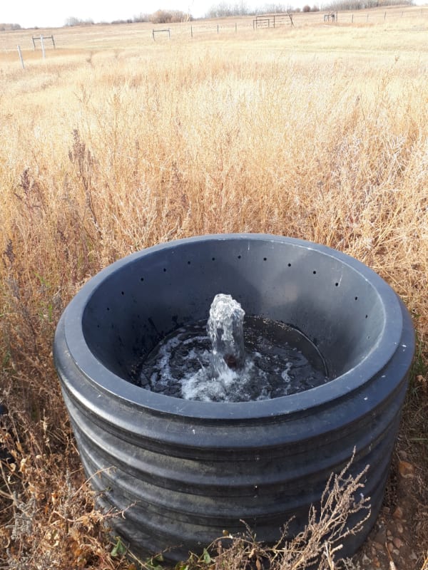

The vertical, flat black culvert section may be heated above ambient temperature on a cold, clear, sunny day.
I wonder if that may be an issue?
I am going to town today and am considering buying a couple of rattle-cans of flat white paint and painting the culvert white.
Any comments?

The water bowl has cracked badly. It is losing a lot of water.
The cattle are there for extended periods, but it doesn't seem to be running on after the cows leave. The run on issue may have been a fault in the previous motion detector.
The culvert is no longer flat black. The sides are now covered with frozen water and cow slobber. That is probably masking it better than a paint job would.

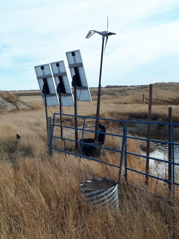

The tall grass and weeds have been cleared away.
Looking easterly. The fence is running east and west.The galvanized culvert was a previous installation. This was a wet well that was connected to the dug-out in the background by a pipe, buried below the frost line.
An excavator was cleaning the digout and inadvertently "cleaned" the buried pipe.

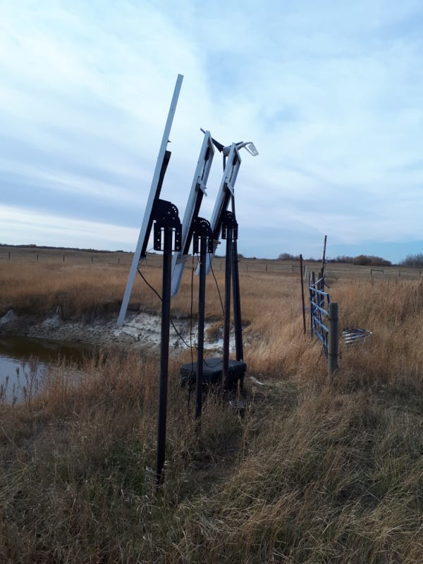

Looking west.

Those pictures helped (me) immensely, except where is the sensor?

In the last picture, the motion detector is mounted about 6 feet high on the furthest vertical post,pointing to the right.

It is on a substantial pipe driven into the ground. I will check for rigidity.
It is pointing north.
It doesn't see the water (until it is already in trouble) Something has to hold the pump on for five minutes or more before the water is high enough to be seen by the eye.
