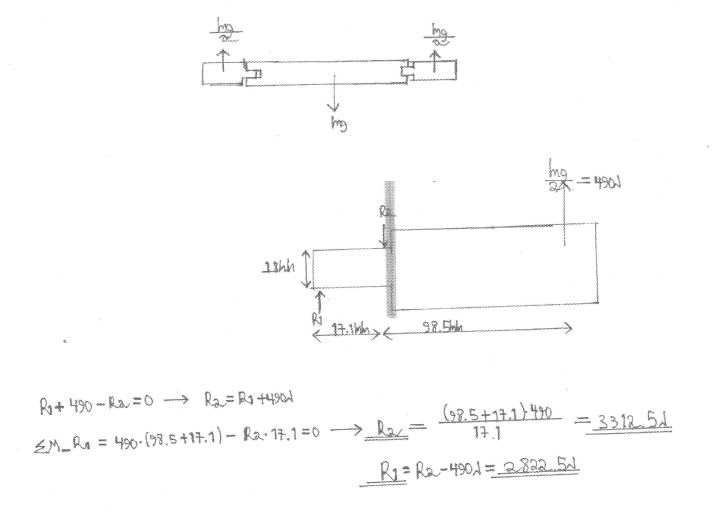

I tried to have a FBD (Free Body Diagram) of the threaded pin part, which I suppose is the critical one.
Here is a picture of my FBD:
Here I try to find the internal (in the critical cut) forces and moments by equilibrium:
After finding V and M I find the shear stress and the normal stress using V/A and (M/I)*R correspondingly, and using von mizes relation sqrt(sigma^2 +3*tau^2) brings me to 80 Mpa.
The problem is that in the analysis I get around 25 Mpa.

Any dimensions? Could be your first FBD is mostly correct. I think I would model it as a cantilever with a moment applied to the left end and R2 as shown.

describing the moment restraint within the socket as a couple is "simplistic", and I'd rather keep it as a moment.
There is no interference, H7/g6 is a "sliding" fit, so dismantling shouldn't be a problem.
About moment instead of couple - I didn't say both reactions are identical, hence it's not a pure moment (a couple) but reaction forces as might be in the real case. In my opinion the bushing can't provide the pin with moment as suggested earlier, but only forces.
A moment as a reaction would be taken into account if, for example, the parts would be welded to each other.

relevant to your FBD ... what's the distance between R1 and R2 ?
a) the width of the blue/green overlap (as though the blue shaft has "cocked" in the (large) green socket hole, and is contacting at the extreme ends) ? or
b) 1/3 of the width ? (why would I think this ??)

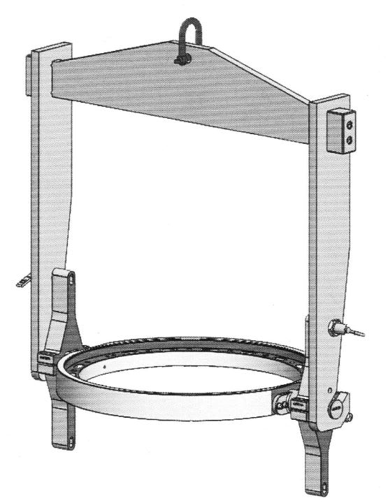

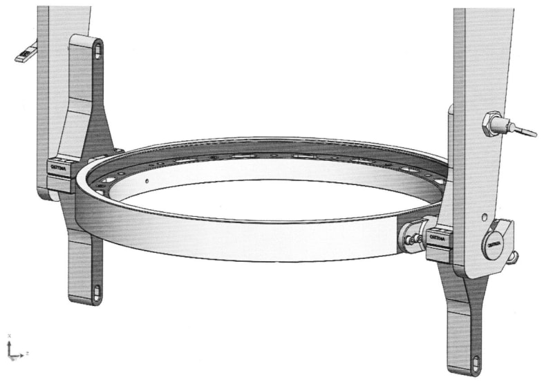

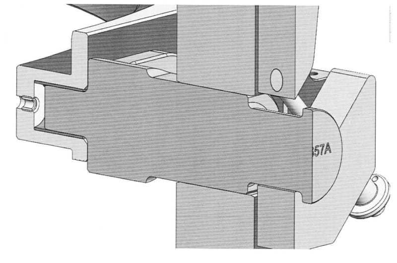

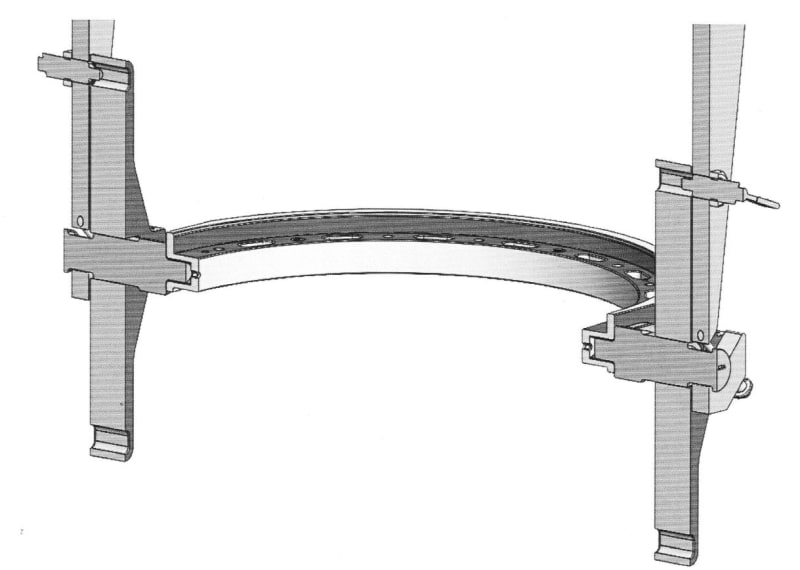

Here are some photos of the design.
You can see that the lifting pin has a supporting flange with bolts.
But the Engineer who is in charge of the safety required calculating it as if there are no bolts and there is no support by the flange.
The motivation is making sure that improper use of the device may not immediately lead to a failure.

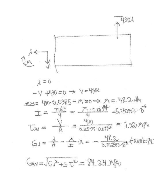

Here is a calculation of the stress in the critical cut under the assumptions above (reauired by safety).
It would all workout better if you used a taper fit rather than a clearance fit, with a straight start and hole.
Since the bolts are on the neutral axis they don't help much. The thread is shown in bending, unlike the original problem statement; not an ideal condition as it creates a stress concentration, possibly 5 to 10 times the expected stress.
It looks to me like this arrangement will twist the ring and then the pin will sit at a substantial angle in the cradle.
Is this a copy of an existing product?
yes, it looks sort of magical, but then I don't think we're seeing the complete story.
ok, your calc is 84 MPa, looks reasonable. why do you "think" the answer is 25 MPa ?
I think you're close enough for a bush job on this one already but for the sake of debate I think your reaction will actually occur on the 'face' of the pin which mates with the outer ring diameter. I would treat the spigot end as a fail-safe should the 4? external fasteners fail to hold that joint tight.
This approach makes no difference to your hand calc which seems correct enough to me although I'd probably set my inital free-body diagram up a little differently as a result. It does make a difference to how tight the spigot fit needs to be (not very) and whether you develop concerning stress concentrations at the section step.

Well it appears we agree with the analysis, however I still don’t understand how the whole bottom ring doesn’t rotate along with the flanged pins, sorry for my ignorance.
The pins are held in place by 4 SHCS (two each side) to the ring so the ring can't rotate relative to the pins. The pin in turn is restrained from rotation by the torque arm (clamped to the pin just inboard of the hook) which can be fixed in what appears to be two positions 180 degrees apart by the index plunger on the hook.
