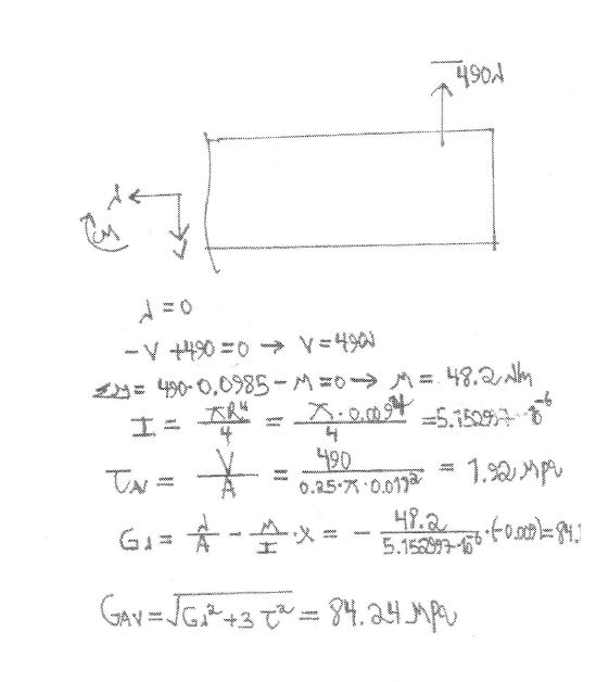

Hey,
I have a conceptual design, and I need to first check its potential strength.
Here is a schematic picture of the conceptual design:

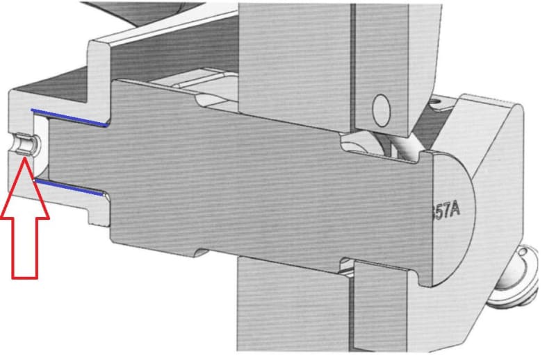

I have a lifting bridge for lifting the weight through its interface which has 2 Shear pins for taking the shear.
The Shaft/Hole fit (marked in purple in the picture below) is H7/g6, so there is a transition fit.
By the way, the thread is loose while the Shaft/Hole fit is tight, so theoretically the Shaft/Hole interface is the one to take the loads due to bending and not the thread, which is there only to axially secure the threaded pin in its place.
I tried to have a FBD (Free Body Diagram) of the threaded pin part, which I suppose is the critical one.
Here is a picture of my FBD:
Here I try to find the internal (in the critical cut) forces and moments by equilibrium:
After finding V and M I find the shear stress and the normal stress using V/A and (M/I)*R correspondingly, and using von mizes relation sqrt(sigma^2 +3*tau^2) brings me to 80 Mpa.
The problem is that in the analysis I get around 25 Mpa.
I have to point out that I already checked a configuration in which there isn't a thread at all (as in the picture below), and the results didn't change.
So I am interested to know which one might be mistaken - the calculation or the analysis?
I just hope you can help me by checking the calculation process I made.
Thanks, I get it now 😀👍
The index plunger doesn't stop the torque arm from rotating away from the bridge frame. If the load is high enough the ring will twist taking the pivot pin with it and move the torque arm out of engagement with the index plunger.
@3DDave - one assumes that the ring is designed with sufficient stiffness to prevent a second order failure of that kind. Given the load is a whopping 100 kg total, it's an entirely plausible design.
"one assumes" isn't good engineering practice when "The motivation is making sure that improper use of the device may not immediately lead to a failure." which may mean this gets snagged and the load is 10,000N.

"The thread is shown in bending, unlike the original problem statement; not an ideal condition as it creates a stress concentration, possibly 5 to 10 times the expected stress" - which thread do you mean? maybe you think the blue interface in the picture below is a thread? if you do, so it's not, it's just H7/g6 fit od the pin to the bushing. if you meant the thread that is marked with an arrow, so nothing is threaded into it at this stage.
"It looks to me like this arrangement will twist the ring and then the pin will sit at a substantial angle in the cradle" - why? 2 is secured to 1 through the bolts that aren't seen in this section view, 3 is secured to 2, and 5 locks 3 and located at 4. as a result there will be only negligible movement due to small clearances of mating surfaces.
"Does the pin thread into the ring?" - no, see my explanation above.
rather_be_riding
"external fasteners fail to hold that joint tight" - why? if they generage axial loads that lead to enough friction (coefficient of friction*total axial force) the pin/hole interface isn't theoretically needed, but is there only for a backup.
In addition I agree that analyzing this problem like I did is very far away from reality, but I should prove this device for the worst case scenario in which no bolts are tightened and no face to face tightening exists, and as a result all the load is carried by the pin.

Dear elinah34 ,
I did not read the previous posts but just screened. The FBD at your 4th post is OK but there are some errors at calculation . ..
I =( Π* R**4)/4 If D=18 mm r= 9 mm = 0.009 m.
I = ( Π* 0.009**4)/4=5.15 *E-09 or ( 5.15*10**(-9 )) M**4
σ = M*y/ I =( 48.2*0.009)/5.15*10**(-9) =84,233,009.71 N/m2 so, 84.2 MPa is OK.
The Von Misses stress calculation shall give the same result .
When you assume the section as a clock, the max bending stresses will develop at 6 and 12 hrs.
The max . shear stress will develop along the axis 9 to 3 .
So the max stress in this case at 6 and 12 aclock.
PS.
1- When you apply FS =4 , ( Common practice for lifting tools and eq.) that makes 337 MPa. what is the yield str. of the material?
2- I f i were, i would consider a different set up.( such as a cross piece lifting frame and four point lifting with cable etc )
as much as we look at the blue pins, we also should look at the yellow lifting beam in the 1st post.

I think the reason you're seeing such a discrepancy between your hand calculations and the FEA results are because you're using σ = M*y/ I to determine bending stress.
Beam bending is only really valid when the span/depth ratio is around 8 (according to Roark)... It appears you have a span/depth ratio less than 1 (L=17.1mm and D=18mm). As such your pin will not act like a beam.
_eh-ngineer
Thank you. Which formula is relevant for hand calculation in such cases ("short beam")?
