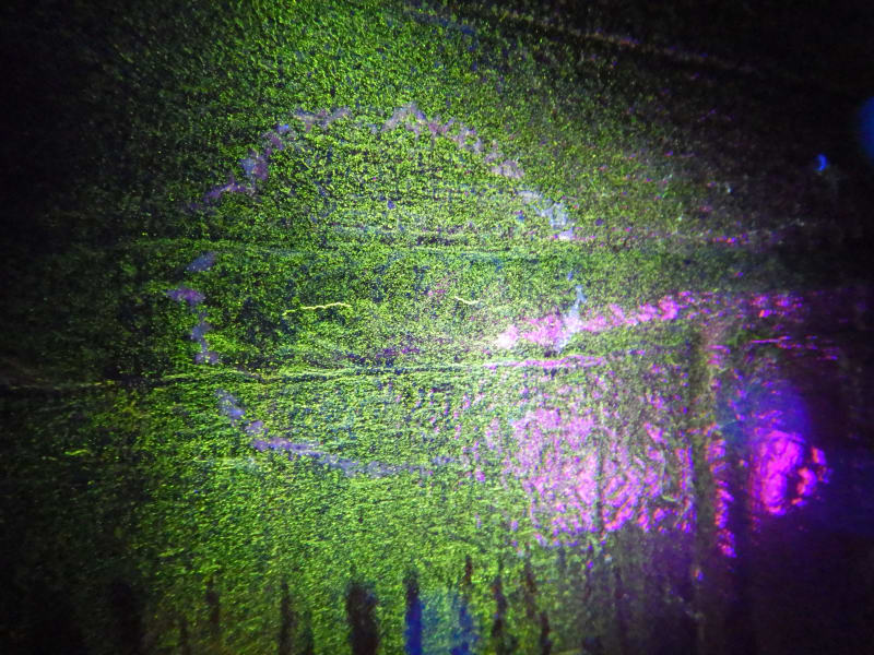

We are doing MPI of all welds in the vessel. Until now 4 indications (cracks) of different lengths has been found all in welds. All these cracks are not visible in DPT. Vessel is not stress relieved and we found fallen coatings from multiple locations. I think built in weld stresses, non-uniform coating and service severity has lead to these cracks.
UFD and PAUT does not seem to fit here due to reduced thickness of vessel. We are not proceeding with any weld repair. I will appreciate if someone can suggest how to check cracks depth?

No structural analysis is performed yet. All cracks are present in one weld and max length of crack is 8mm as found in MPI. We would mainly be focusing on monitoring cracks growth in periodic inspection. We are trying to check crack depth by UT but it has limitations due to vessel reduced thickness.
What risk analysis you suggest and what crack size will be considered critical crack for such a vessel?

At one location, welding capping was grinded up to 1mm but crack appeared as such. Since we did not find cracks in other welds of the vessel so most probably these cracks are due to built in stresses at fabrication times.
I am more interested in finding cracks depth now but not successful so far.
