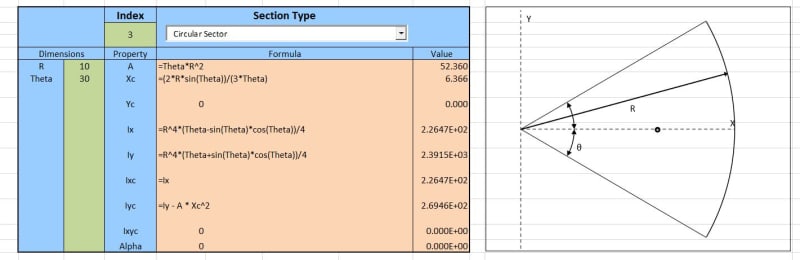

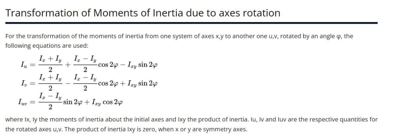

Can you find the results for a segment, with the centroid located parallel to the outer part of the circle, and rotate the values? I seem to recall there was a transformation to the I value based on rotation...
Here's the first part...
and maybe the second...
I think that will do it... just a matter of putting the stuff together, I think. That goes back so far, it makes my head hurt... over 50 years. Having the new moments of inertia, it's a matter of determining the Section Modulii. Let me know if it works.[pipe]

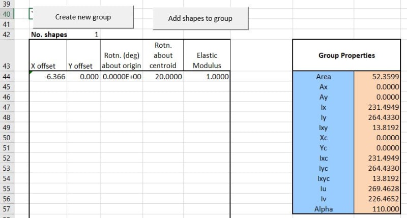

My spreadsheet at:
will find section properties for a variety of defined shapes.
The standard shape for a circular segment is symmetrical about the x-axis, but the group feature allows you to rotate any shape about the origin, which should give the results you need. The link above gives an example of rotating a circular segment through 90 degrees, but you can use any angle.
Alternatively (and the way I'd probably go) you can define the shape with coordinates and get the section properties for any shape.
Doug Jenkins
Interactive Design Services

Just tried the spreadsheet, and it seems to work OK:
On the DefShapes sheet, select "Circular Sector" and enter the radius and theta:
Scroll down to the Group properties input, enter -Xcentroid as "X offset" and the rotation angle, then click "Create New Group":
Go to the Coords_Group sheet and click Plot Group. You can then find the coordinates of the three corner points, with the origin at the centroid, which you can use to calculate the 3 section modulus values:
I have attached a copy of the spreadsheet. Please ask if any problems.

do you want a sector, which is easily done, or a generalised shape ?

So then it’s a matter of determining the moments of inertia about the principal axes per DIK’e post and resolving the moment to the components about the principal axes, no?
I'm pretty sure of it... and then S can be determined by the x and y distance to the outside fibre. If I'm bored tomorrow, I'll do up an SMath program. Nearly finished my lag screw one, but want to check the output with an actual connection design program. I don't have one, but my colleague Vic has one... he's the wood expert I use.
I guess the formula's correct... I didn't check the derivation... just plugged numbers into a formula... and if you set the angle of rotation equal to 0, you get the same values for no rotation... something seems to be OK.
