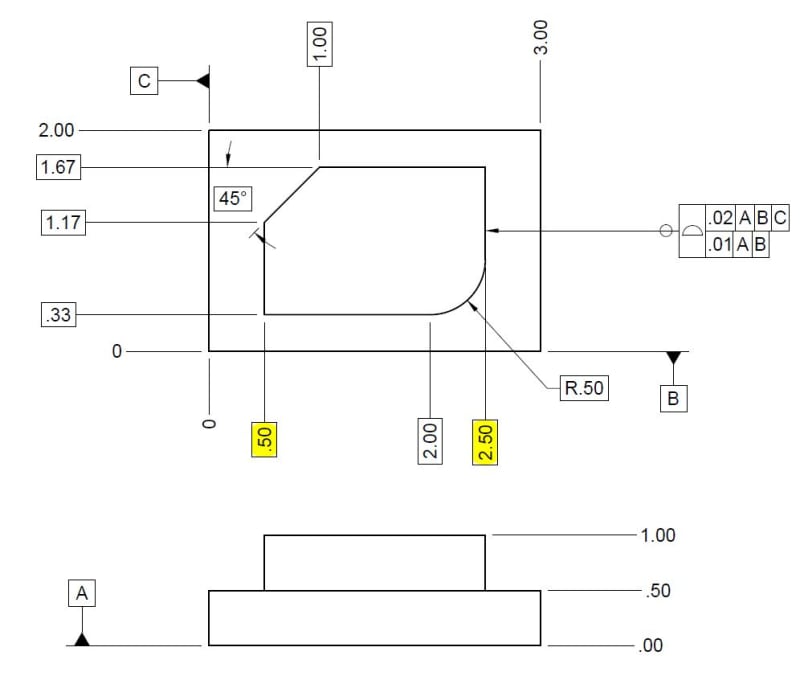

Am I interpreting the profile of a surface callouts correctly. The tighter tolerance is only referencing datum AE. So am I correct this tighter tolerance only affects the red lines as seen below?
Thanks...
sendithard,
The all-around symbol is applied to the leader line so the profile applies all-around the indicated profile for all segments of the profile tolerance in question. Datum feature references do not change that - they only change the constrained DOF for each segment/tolerance zone. In this case, you have a composite tolerance so the lower frames (FRTZF) can only constrain rotational DOF wrt your DRF.

Below is a simplified drawing. From my understanding the top tolerance is the simple tol zone you would expect. So all around that upper vertical surface can deviate within the .02 tol zone.
Here is when I get confused. I think the bottom tol zone dictates the tol zone each feature can deviate from each other. If this statement is true then given there are no dimensions showing distances b/w the profiled surface would you just do the math from the existing basic dimensions? For instance just take the difference b/w the yellow dimensions and both those surfaces must hold to a zone of .01 from each other?
My next question would be since the bottom tol zone includes the A,B drf would the .33 dimension still be required to be measured within the tighter .01 zone b/c Datum B is in the drf...whereas if it were datumless would each surface just be held to each other without concern over distance from Datum B and perpendicularity to Datum A?

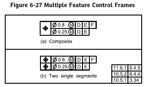

First off, just to get it out of the way before I make any assumptions since you already stated you do not have access to the standard I want to make sure I clearly define the difference between a composite and multiple single segment tolerance. A multiple single segment allows constraint of both translation and rotation in the lower segments, its basically just a special case of two or more separately applied profile (or position) tolerances. A composite tolerance, which you have shown here, does NOT allow constraint of translation in the lower segments (FRTZF) - ONLY ROTATATION. Ie: any location with respect to your datum features does NOT apply in the lower segments/FRTZF of a composite tolerance.
Note the differences in notation (in this case position, but of course same applies for profile):
Both tolerance zones must be satisfied. The feature must be within the upper segment (PLTZF) a zone .02 wide equally disposed about the true profile and constrained to |A|B|C|. The feature must also be within the lower segment (FRTZF) a zone .01 wide equally disposed about the true profile and constrained in rotation only to |A|B|. Thats it. The effect is that the .01 zone effectively "floats" within the .02 zone as anything outside that is non-conforming, but they can essentially be considered/verified separately.
Individual dimensions aren't really verified/measured like that with a profile tolerance - even if one might be led to believe that by the way some QC departments set up their inspection reports. As I noted above, the surface must be within the respective profile tolerances when constrained to the applicable datum features. The .33 dimension is not really something to be individually verified, but in turn locates your true profile - ie: when datum feature B is invoked/specified in a DRF that can constrain location (ie: NOT the lower segment/FRTZF of a composite tolerance*) your true profile is located .33 away from the datum feature simulator for B and your tolerance zone is equally disposed about this true profile. This concept expands to any datum features in a DRF which constrain location, and obviously with a datumless tolerance there is no location/rotation constraint - only that the surface must be within a tolerance zone equally disposed about the true profile not constrained to any particular DRF.

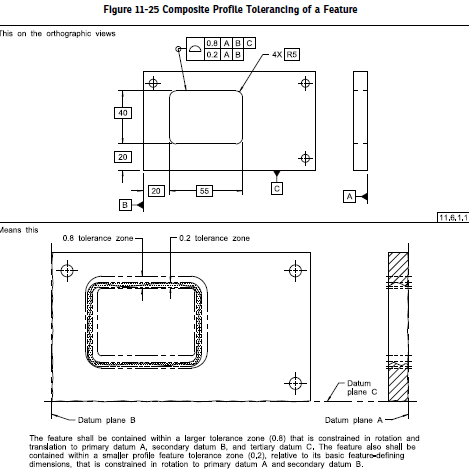

*Lower segments/FRZTF of a composite tolerance can only constrain rotational DOF even if B is specified. This is NOT the case for the upper segment/PLTZF.
I know thats a lot to take in and a lot of words. This is where the standard is helpful. See below for an example of what I mean, note how the lower segment essentially floats within the upper segment.

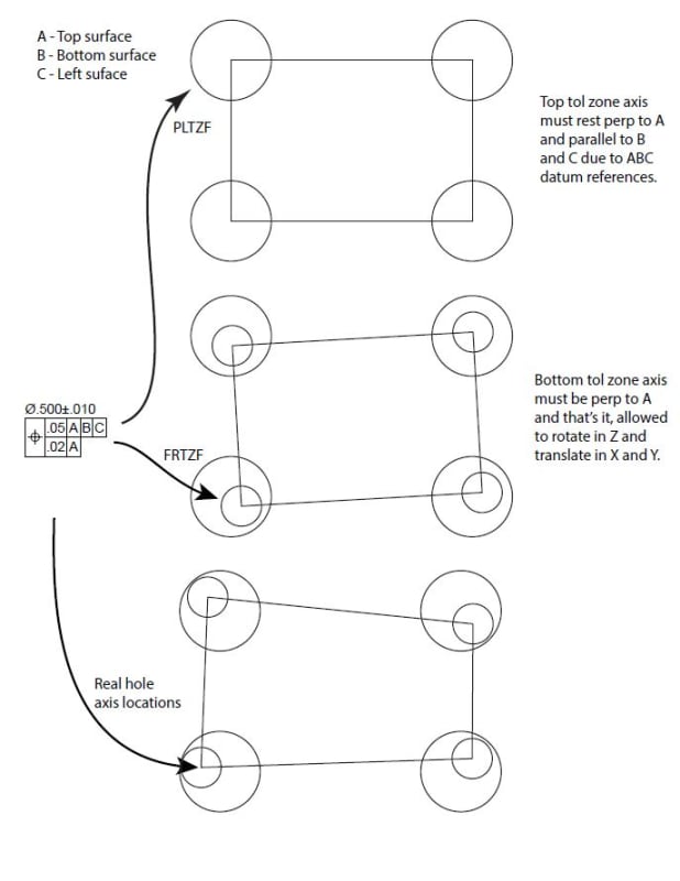

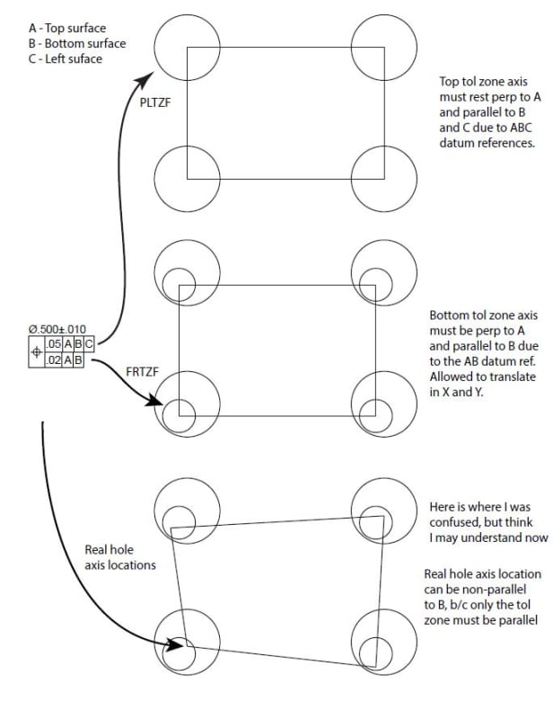

I'd like to share with you what I came up with and see if I am thinking right now. When I began visualizing this using positional tolerance instead of profile of a surface it began making more sense.
What I'm showing below is probably obvious, but the larger circle is just the top tolerance and the lower tolerance is resting inside it. The datum references dictate the translation and/or rotation that can take place of the tolerance zone inside the larger tol zone.
If AB is used in the lower, I believe you can no longer rotate in Z, but can still translate the 2nd zone in X and Y. Then if only A is used you get the additional rotation in Z.
I get confused as to what happens in this 2d view when there is no datum. Since you just remove perpendicularity to A how does this affect this zone and top view that we are witnessing?
Thanks again....here are my diagrams below....
The holes don't need to go straight in without a reference to A. They can all be at a steep angle, depending on material thickness.
Your question answered itself, in a sense: "I get confused as to what happens in this 2d view when there is no datum."
Expand from 2-D thinking to 3-D thinking...If you add a different view (side view, for instance), then try to visualize how the small zone could rotate relative to datum A, since the lower portion would no longer be referencing datum A.
In other words, the holes could be drilled at an angle (still within the perpendicularity allowance of .05) yet be perfectly oriented to one another.
