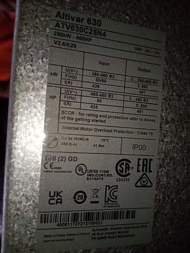

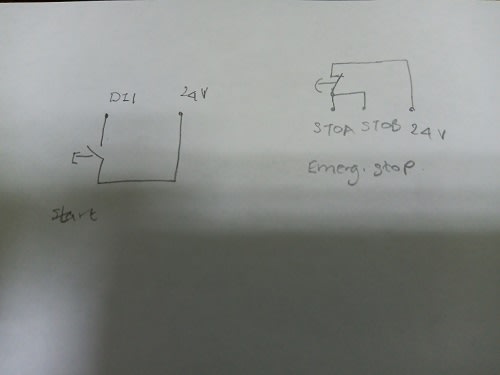

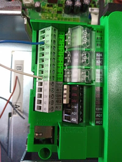

We have bought a new VSD and we are testing in workshop before installing on site. We have connected the control signals as attached. We have set a min frequency of 38 Hz. We have connected a small motor 0.37 kW for testing. When we press start push button, we can hear the VSD fan running as if the VSD has started but the motor does not rotate. We have set the kW and current the lowest possible in the VSD.
When we press emergency push button, the VSD stops. Can you please tell me what may be wrong and why the motor does not rotate?

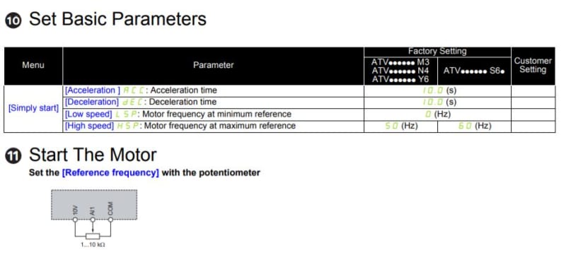

What have you set to the min frequency 38 Hz ?
Have you followed this simpel start example?

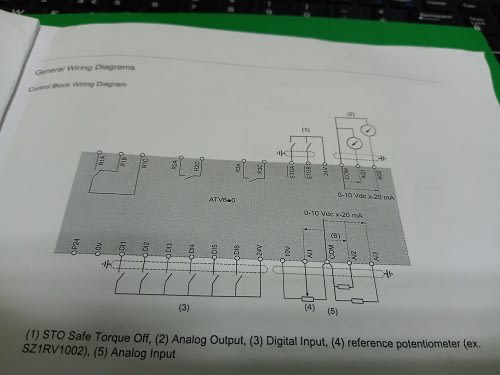

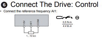

I cant se that you have connected any potentiometer.
It is difficult to help without knowing what parameters are set or not.
Best Regards A

The VSD will later drive a submersible pump whose mini speed should be 38 Hz.
The small motor is 3 phase 400 Vac
Should we connect a potentiometer?
I have already set the basic parameters.
If the 24 VDC, AI1 and COM is chosen as the the drives setpoint value (reference frequency input) you cant not drive the motor without it.
I do do not know which other inputs that can be used or selected for this?
If you have chosen some constant speed reference in the parameter set, that must be chosen as the main frequency set instead of the analog input.
I am not sure what your nominal frequency is in Mauritius 50 or 60 Hz
I would suggest that you start with setting your reference frequency to that or to the motors nominal frequency to see if it will start running and then go down from there.

We have connected a potentiometer. When we vary the potentiometer, we can see the freq changes on the display.

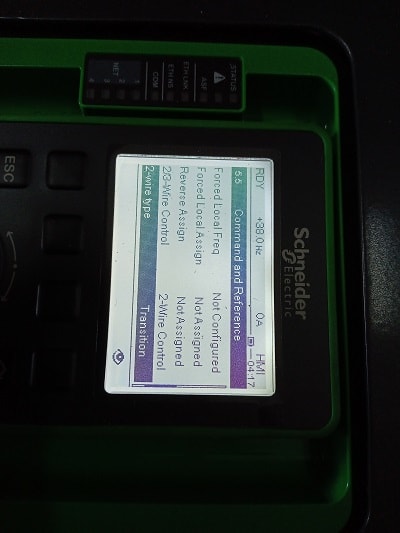

We have connected a stop push button with NC on DI2 and set to 3-wire. But the VSD does not start when we press start push button. We removed the stop push button and set to 2 wire. We must press the start push button continuously for the VSD to start. Else it stops after a few seconds.

DI.1 is not "start" it is forward or run meaning you need to have it high all the time when you want to run or run forward.

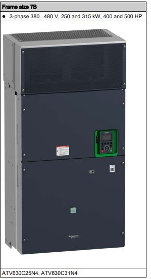

According to the Manuel the drive is made for 250 kW to 315 kW
Meaning that it is what the drive is trying to autotun.
Even the lowest output current would be to high for such a small motor.
Honestly I don't think I have made a autotun on a standard 3 phase AC motor, normally if you have all the motor data it is enough to get it up and running to begin with.

3-wire control settings activate inputs DI1 to stop (NC) contact, also DI2 is now a start command with a (NO) PUSH BUTTON activation. Link: . Running autotune on this test motor will provide no useful information for your much larger (motor) installation.
Testing the drive as you are. The benefit to final installation will be only confirmation of field wiring and some parameter settings, until wiring to the real deal. Good luck
We have connected stop to DI1 and start to DI2 and set 3 wire. It is ok now.
