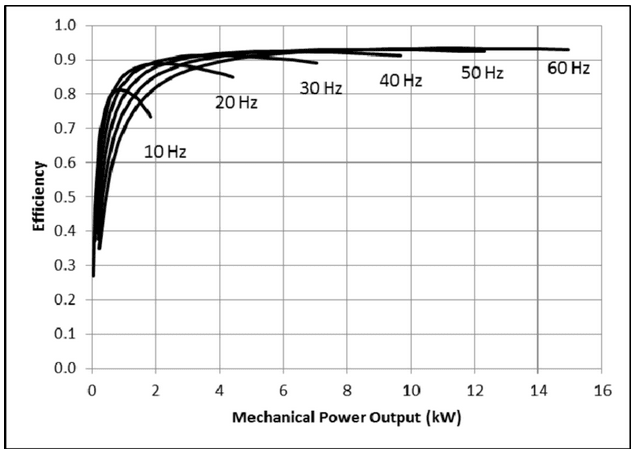

Usually energy audits have enough inconsistencies and "metering errors" that it is not worth the effort to overly refine the "estimated efficiency of energy conversion. For these studies it is necessary to develop a constant method of analyzing the data, and stick with it. Fortunately the method has been provided to you.
If your purpose needed accurate motor efficiency data, be aware on a system driven by a VFD at variable speeds, the motor efficiency will be a function of:

To get the actual efficiency map, likely requires putting the motor on a dynamometer. Sounds like the stuff of higher education research papers.
The following chart may be valid for a single tested motor, and could be used to talk about the issue. It does show the point made previously, efficiency does not change much with shaft speed, until you are operating at less than 1/2 design frequency.
