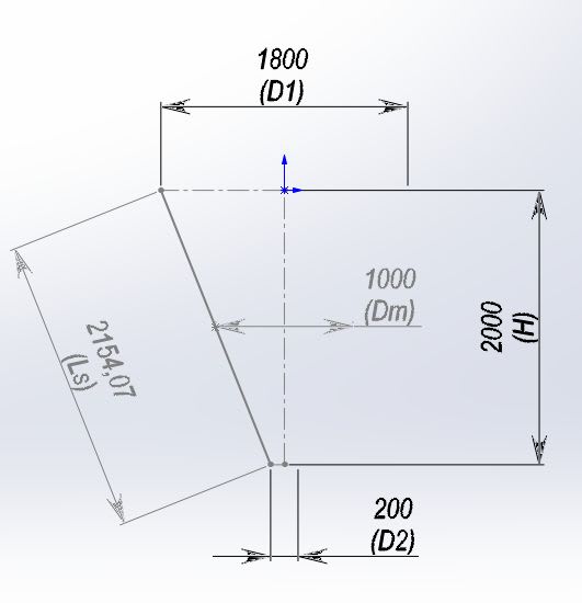

Hi
In chapter 10.4.4.2.2 has 2 variant:
a) for short conical shells - L < 6*Dm
and
b) for long conical shell - L > 6*Dm
And has Figure 7, but i dont see L and Dm:
Ok, i think D1 and D2 a draw red pen, so Dm = (D1+D2)/2
What is L? L=Ls? Where i can find L value? L is all length/height of tank?
John

Ls distance between two stiffeners or supports (inc stiffened regions). Dm mean diameter of cone.
I think L is Ls (as small distance between stiffeners (any) will have an effect.
Best solution/check is to design cone to BS4994 to check logic of decisions regarding dimensions to use.

Thank you very much for your reaction to my question.
Ok, I'll try to accept your offer that L = Ls.
Then in the picture below the "short" cone:
L = Ls = 2154 <6 * Dm = 6 * 1000 = 6000

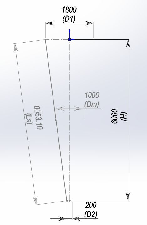

And in this picture "long":
L = Ls = 6053> 6 * Dm = 6 * 1000 = 6000
The vast majority of my cones will be "short".
This seems to be true, thanks.

I think your diagrams are correct: Ls is slant length and you can find mean diameter.

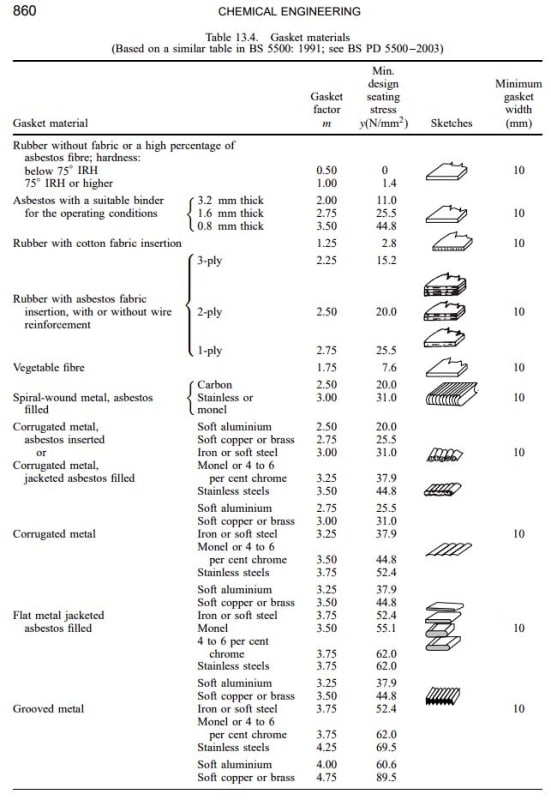

>>Have you calculated the manhole flanges yet? What gasket stress have you used? What gasket material?
We calculated the flanges of the hatchways. I took the data on the gaskets from the book "Coulson & Richardson's Chemical Engineering", page 860, attached
I use Rubber whithout fabric below 75IRH
All book at link
John
Your reply regarding stress to gasket is zero, simply can not be true. There has to be a value otherwise leakage.
BS4994 suggests (and has always worked for me) at 2.32 MPa (N/mm2) For many years we have used EPDM gaskets because they tend to be softer than the thermoplastic face of
the flange (in UK we build a lot of thermoplastic lined (PP or PVC-U) /GRP) external tanks (and some vessels). The soft EPDM seems to cope with surface scratches better.
The objective is to compress the gasket (over a narrow band just inside the bolt circle) say a width of 5 mm - 6 mm.
Flange design to BS 4994 were copied from BS 5500 (steel construction) - which has a minimum seating stress of 2 MPa (for soft rubber).
EN 13121-3 uses two (2) different gasket stresses Qmin (seating stress) of 2.5 MPa (without reference to actual gasket material). And QsminL.
Part 5 uses 5 MPa operating (QSminL( and 6 MPa bolting up stress (Qmin). But part 5 is very thick all GRP flanges and was not intended to be helpful.
In the eleven pages of corrections; I think one of the things corrected was gasket stresses.
In the UK we are plagued with rubbish grade EPDM sheet. From China (of course) with lots of cheap fillers - making the EPDM far less soft than it should be.
(but it is cheap).
My plan. We had three grades of EPDM (50 - 65 IRHD) tested for compression modulus by Semperit of Austria (a trusted manufacturer). From that data I can determine
what stress is required to compress the gasket by 33% and 50% (via FEA models).
There is a document by The European Sealing Association (title Tightness in gasketed flanged unions) and refers to EN-1591-1 standard. It also lists no less than
five gasket parameters (surface stresses) which are used to calculate the flange/gasket/bolting.
I reckon the gasket stress should be between 2 and 4.5 MPa (unless good reason not to be).
