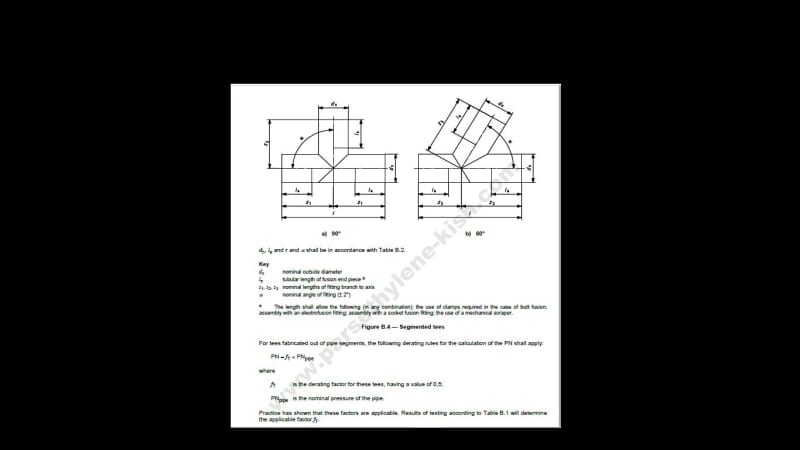

i have problem in filling HDPE Pipe , Header and Branch Table ,
i need to know what standards and Codes need to check and read For Fill that table , i'm not familiar to HDPE Codes and standards
Please guide me , Thank you
Project in Australia and ( DIN , ISO OR AS ) are accepted by Client

I think the table you posted is a snap , copy and paste from a manufacturer's catalog.
You may look DIN 16963 for the size of HDPE tee's.
Will you provide more details ( service, pressure , connection type...) ?
When the header size large and branch size is small, you may consider the use of tapping saddle ( ferrule strap ) ..

I am not sure what your problem is exactly ..You also may look ISO 4427 for PE pipes and fittings.
The following is a snap from ıso 4427-3 .
If the service is firewater network with service pressure 1200 Kpa , with pipe sizes 355- 315-280-225-180-125 mm,
i would suggest to consider the use of ductile cast fittings and bends.
Probably you have spoken with PE fittings manufacturers and probably they proposed fabricated bends and Tee's.
IMO, the use of HDPE fittings for fire network, is playing Russian Rulette. Consider , just my thoughts.

i will Check Iso 4427 and relevant, i think , the require information exist in ISO .
