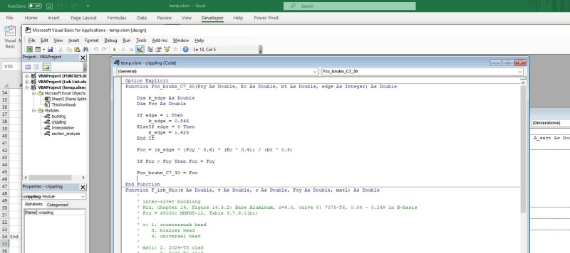

I have a s/sheet from a vendor to refers to a formula "Fcc_bruhn_C7_30(...)".
I recognise what the formula is trying to do, but I can't find the expression in the s/sht.
Thoughts ?
where are macros defined ?
sorry Excel 11 (I think !?)
found "macros" (on the "view" ribbon ... Y oh Y) ... but my formula isn't there ??
actually Excel 2016

thx greg, tried that, got the usual Excel "WTF?" ... (screen shot attached).
I think this means the formulas/macros are on the vendor's computer and didn't ship with the s/sht.
If I force a re-calc I get "WTF?".
 https://files.engineering.com/getfile.aspx?folder=23655d03-5384-4d15-a59f-f76df3eb5215&file=Screen_Shot_11-05-21_at_03.48_PM.PNG
but humm ... if I change the precedents, the result changes ... so the formula is live ? but doesn't survive "cut and paste" ??

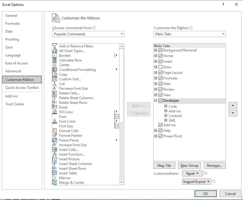

rb: Developer tab. Visual basic.

thx guys ... it'd help if I had the "developer" tab on my ribbon !? must ask "Mordac" ...
Oh yeah...not on by default. File > Options > Customize Ribbon
damnit ! I was looking for that ribbon thingy ...
I should have looked at your screenshot, yes developer->view code
Function Fcc_bruhn_C7_30(Fcy As Double, Ec As Double, bt As Double, edge As Integer) As Double
Dim k_edge As Double
Dim Fcc As Double
If edge = 1 Then
k_edge = 0.566
ElseIf edge = 0 Then
k_edge = 1.425
End If
Fcc = (k_edge * (Fcy ^ 0.6) * (Ec ^ 0.4)) / (bt ^ 0.8)
If Fcc > Fcy Then Fcc = Fcy
Fcc_bruhn_C7_30 = Fcc

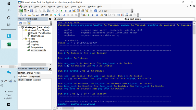

As you can see there are 4 modules in the VB Editor…
buckling
crippling
Interpolation
section_analysis
Each has one or more procedures (subs & functions).
Fcc_bruhn_C7_30 function is in crippling.
flng_sect_props is in section_analysis.

Some more hints for working with VBA:
Alt-F8 will open a dialog with a list of macros (i.e. routines defined as Sub()), and you can choose Run, or Edit or Step Into to view the code.
Alt-F8 will not display functions, but if you start to type =function_name the VBA functions will be included in the list of available functions, as well as the built in ones. You can then select the one you want, and click on the function wizard (fx, next to the name box), to see the required input.
To view a function code you have to go to the VBA Editor (Alt-F11, or Developer tab, if you must), then search for it. If using the search function (Alt-F), and you want to search all modules, make sure the search Project option is selected.
To step through a function:
- Go to the function code in the VBA Editor, and set a break point near the start (or from wherever you want to step)
- Go back to the worksheet and select a cell calling the function, then press F2-Enter.
- You can then step through the code with F8, etc, as for a subroutine.
