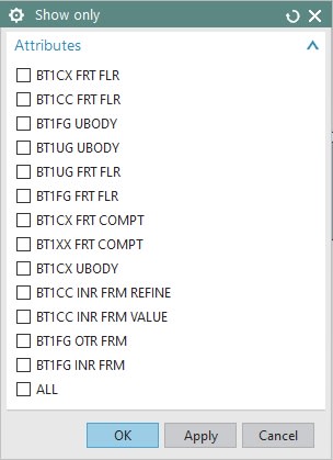

I apologize if this is asking for a difficult one to make. I am hoping if it is a tough one that someone will take it as a challenge. lol I am also hoping someone already has something similar.
We have what is called a Datum File that has multiple files together. There are around 6,000 spheres that are attributed. We need a way to hide and show bodies according to attributes they might have.
This is a list of attributes these bodies might have....

The bodies might have one of these attributes or multiples of them.
When they have the attribute, they seem to always have the value "TRUE". I think it would work if the journal just looked for the attribute itself, but it is possible the value is important.
They would like to have a way to hide all but the ones they want to use, according to these attributes. I would picture having a pop up with this list of attributes and a check box in front of them, so they can just check the ones they want to see, and all others would be hidden.
However, if that is too difficult, if they could even have a drop down list and select only one to show and hide all others, that would work. Check boxes would be awesome, but either would make them happy.
NOTE: This would need to blank bodies in either the current work part or other parts in the assembly.
It would also help if there was an "All" option in case they want to turn them all back on. This is not necessary though, because they can use SHOW ALL. I could just see a time in the future where they might have other things hidden like product or something and they wouldnt want to unhide all.
This list is the attributes the journal would need to search for, but in the check list or drop down, it might be better on their eyes if "USAGE_" would not be there. Just so long as it looked for the correct attributes.

Hi
It requires usage of block UIStyler dialog (Attached image) box with NXOpen combination to solve the requirement. Please create a dialog box as per attached image. I am able to solve the requirement with NXOpen C# API.

To be honest, I have no idea how to create a dialog box. I will have to look into that.
Looking at the one in the image, it makes me wonder how long it would be if it had 50+ options. Would something like this be hard to create with multiple columns? Likely if I figure out how to make the box I will answer that myself. lol

I found how to create a dialogue box through the developer tab. However it does not seem we have a license that I can save it or anything.
Also, I messed with it some just for the experience and knowledge and I could not figure out how to do something particular. Because we currently have 48 options and more will be added in the near future, I was curious to create a dialogue box that would give a list of programs (BT1CC, BTIFG, etc...) that will show up collapsed and if you expand them you would get all the options with the check boxes. I could not find a way to create a collapsible list much less how to place toggles inside another option.
