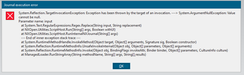

sometimes I get this error, when I run the code, after taking all objects out of the reference set, its a bit random

The error message shown confuses me; it errors on a call to Regex.Replace, but the journal code does not make use of regex at all. The closest it gets is a string comparison on the ref set name. Did you incorporate this journal into your own code? If not, it must be part of the code that NX is executing internally.
i don't think the "show exact" does anything to help it.
I'm using the code as it is without any mods.

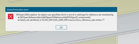

To get an error, try this..
8. go work part on the component, using the code hover over a body and wait for the dots, for selection scope.
9. select the "component" from the list, ok to get an error
My question is, Why do I even get the option to pick the component? (from inside the part)
